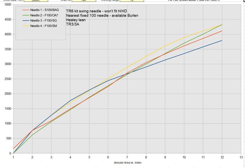

APT got back to me . BAG is the Swing needle used in the HS6 TR6 conversions. Won't fit in earlier carbs - HS6 and HD6 require a fixed 100 needle for the 100 jet. These are comparisons of the jet area with the needle. Note the TR3 is richest of all:
From Ian Hamilton's "Needles.ods" spreadsheet

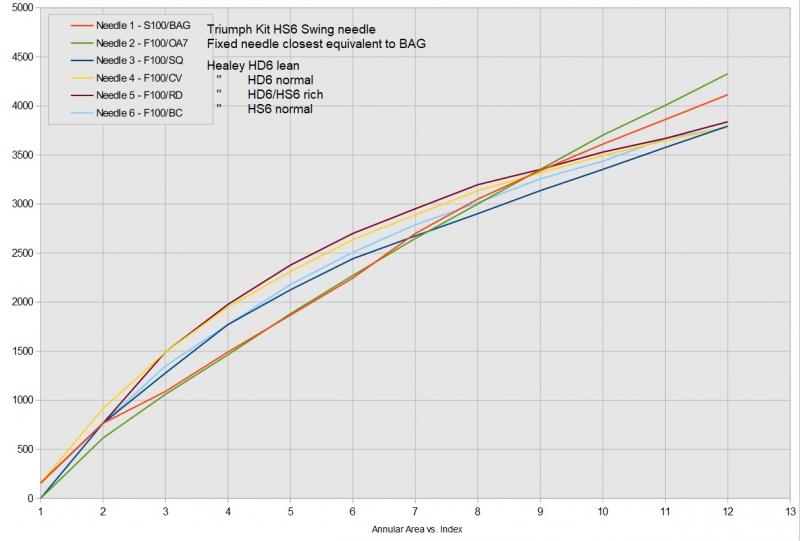

Edit: Healey BJ7 HS6 normal (BC) added. Healeys run the 12oz Green spring - that would make the BAG run a little richer.
