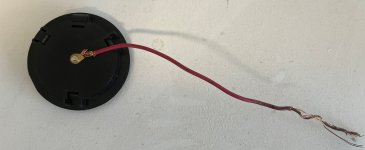

I pulled the steering wheel and there was an bad wire connection. The purple/ black wire is too short inside of the steering column to make a proper connection to the horn switch. I will probably have to pull the purple wire back under the dash and splice in a new piece to give me the proper length.
With the purple/ black wire not touching anything, the horns are not sounding, because it is not shorting out to ground.
Is this horn switch going to work? how does is go to ground to complete the circuit?

The horns don't care about polarity. They work with 12V to them and depend on a ground at the horn button to work, so if the horn push is an open circuit until you push it, then closes to a ground point (the steering column), things should work.

I had to rebuild the switch in the steering wheel so it would make contact when depressed, but not when it is not depressed.
How can I get slack in the purple/ black wire to connect it to the switch?
I cannot find where it comes out of the bottom of the steering column.

There was a purple wire that was too short to connect to, I needed to extend it to the switch. I could not find a way to get any slack. I figured it must somehow connect to the copper bushing. After thinking about "what's the worst thing that could happen", I decided to pry the "crimped" end of the bushing to unlock it from the shaft. I was able to remove the bushing and locate the other end of the purple/ black switch wire, it has a spring on it which supplies pressure to drive the end of the wire against the inside of the bushing. I was able to pull the wire out of the housing and solder an extension onto it and heat shrink the joint. I cleaned, lubed and reinstalled the mechanism and the horn worn properly!
