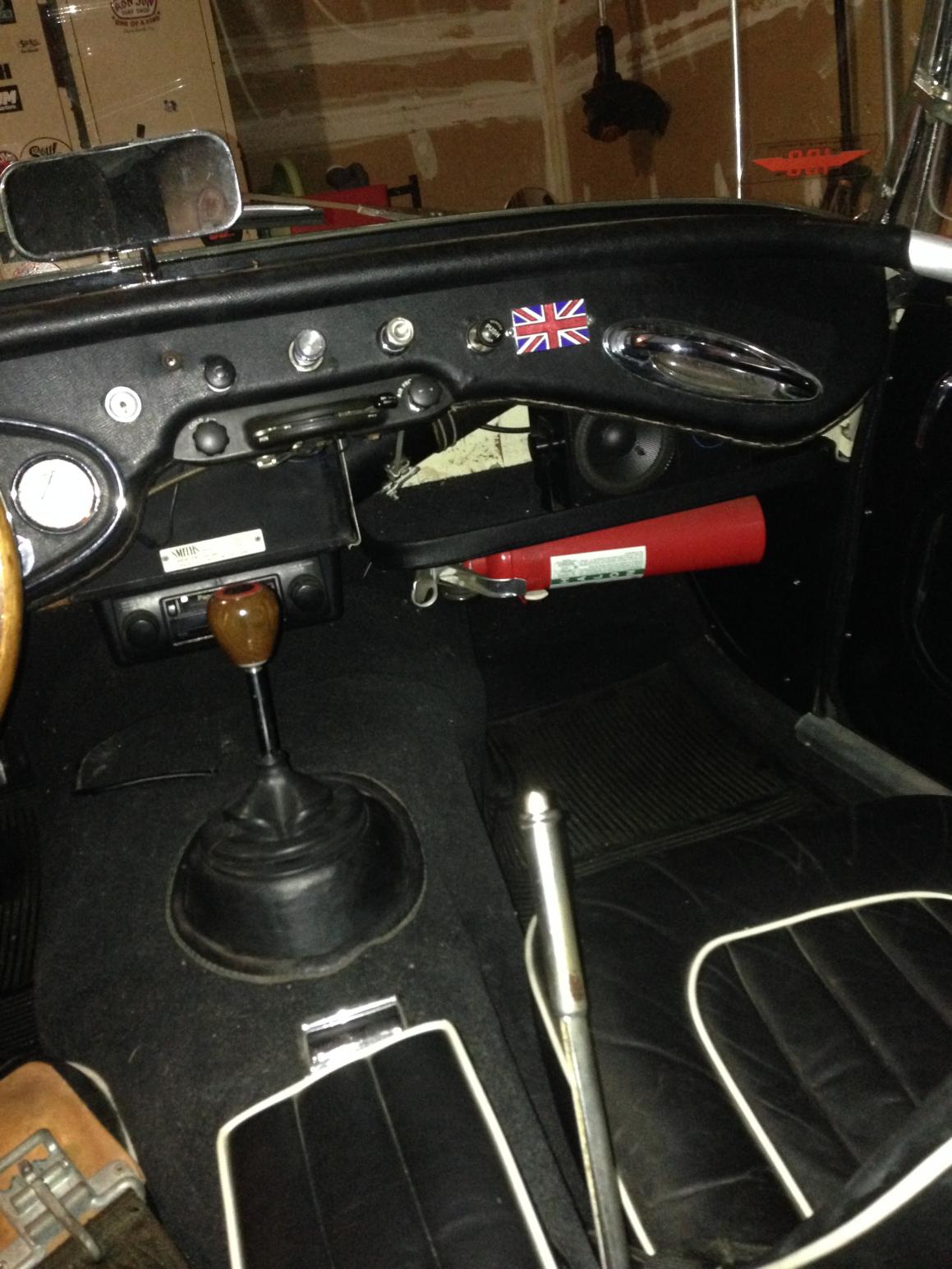

I've mounted mine right above the transmission tunnel. It's always in my view, if every needed.

Dougie - Very cool, well fitted interior. I like the fire extinguisher placement. Just curious - what's the yellow button/tab on the bottom right steering wheel yoke? For autocrossing, I used put a piece of red duct tape as a "this end up" indicator on the top of the wheel but what this is plumb evades me.

dougie
Ha, I had to go back to the picture to look....Ear plugs, I usually place them under the rear view mirror. They're another item I want readily available.
