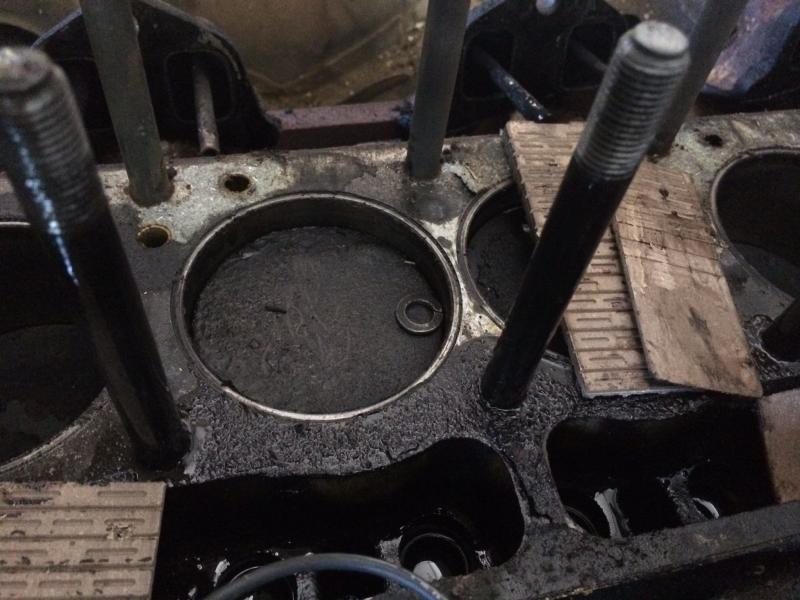

I bought a TR6 a few years ago and heard this strange noise after I got it started. It sat many years in the sellers garage.
When I pulled the head I found this lock washer sitting on top of #3 piston.

Wow! Good catch!
You're lucky it didn't do more damage--I suspect a lot of people would have just driven it and hoped the noise would go away.

Thank goodness there was no damage. It was a weird "pinging" sound. The guy I bought the car from never worked on his car and always took it to his "mechanic".
His mechanic probably dropped it and it went into the intake and never said anything to the owner. My eyes almost popped out of my head when I saw the lock washer sitting on top of the piston.

Thumbs up for the cast iron head!
You can say that again! Luckily the walls of the cylinder were fine the only damage was the intake valve was leaking (no surprise there). I have the damaged head in my garage and plan on getting it repaired with hardened exhaust valve seats.
