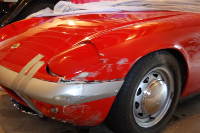

I'm happy to hear he's ok. My Elan had a set of horns that could be heard 3 states away - might be something to consider during the repair job. It shouldn't be too hard to fix, as long as the frame didn't get rapped too hard. As Doc mentioned, the front suspension uprights need to be checked and to that I'd add the front tubular crossmember, which needs to be able to hold a vacuum.

Here's a picture of the damage. Not too bad considering the speed at which control was lost!
