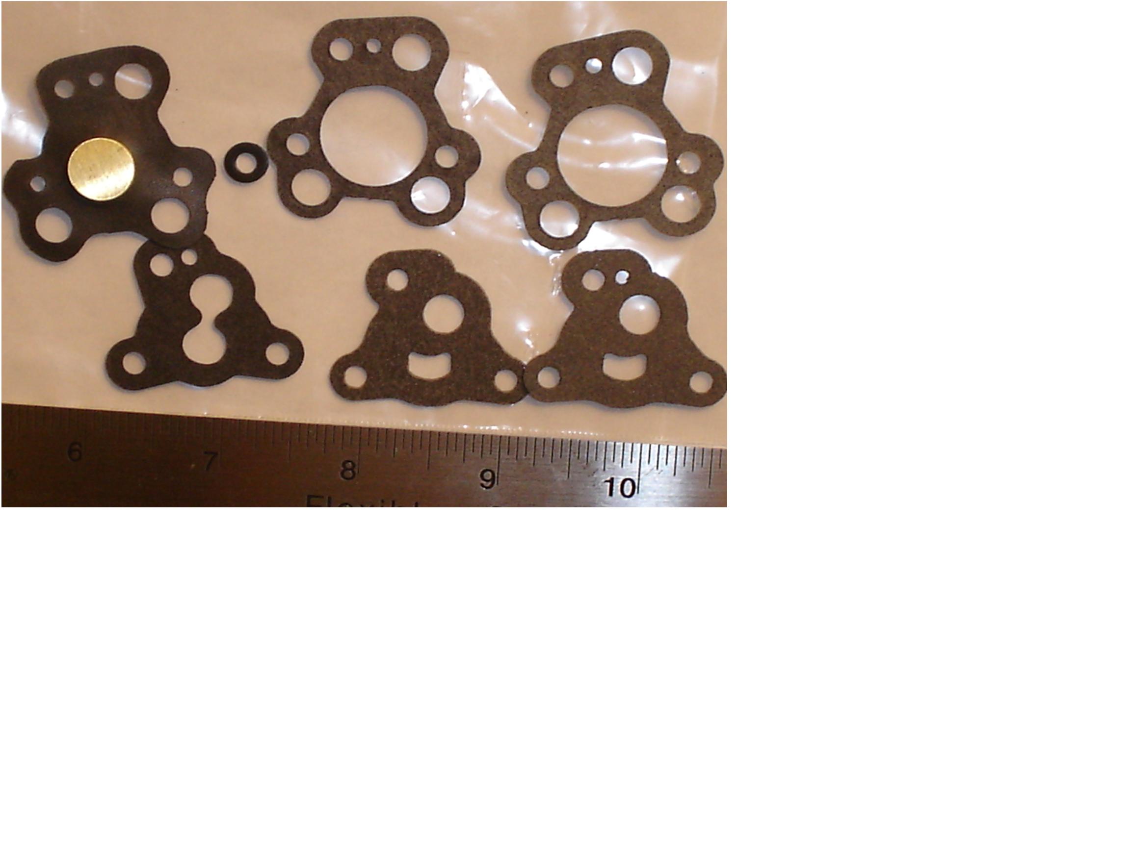

Can you service the Z Stromberg bypass valves without removing the carburetors from the manifold? By the way, I was impressed with the kit I got today because each bag includes no less than 5 gaskets, the diaphragm (with the brass valve in it) and 1 small rubber sleeve. I have to say Moss Motors' service could not have been better.

Do you have a picture of the kit and whats in it?
poolboy
You shouldn't have a problem. There are 3 screws holding the TBV housing to the carb. Get the housing off and all the parts with the exception of one gasket are internal to the 2 part housing.
You'll be better off making the adjustment, if needed, before you remount the housing, because making an adjustment on the rear carb with the TBV inplace takes some dexterity, mostly because of the throttle linkage being in the way.

I don't know if this will be a picture of the kit or if I will be banded!

DNK said:
In the picture I used the diaphragm and sandwich it with the two gaskets on the top roe. The original gasket (original to this rebuild that is) between the carburetor body and the valve is the one on the left of the bottom roe. I don't have a clue what the other two gaskets on the bottom roe are used for. Also, the tiny rubber gasket beside the diaphragm seems to have no place to go. Any help is appreciated.
TR3driver
Great Pumpkin - R.I.P
I don't know the exact applications, but I do know that there were several minor variations of bypass valve (not necessarily all used on Triumphs), and they take different gaskets. So just use the gaskets that fit, and throw the others away.
Could the O-ring be for the mixture adjustment screw?
