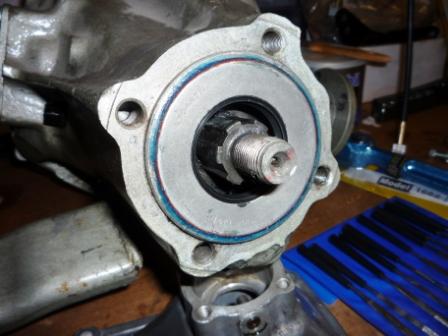

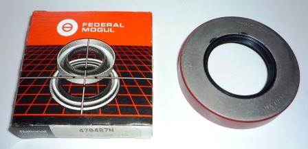

Gliderman8
Pinion seal that I used...

Gliderman8
Here it is installed...
