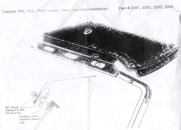

Tom, I have installed the first two (center) Tenax fasteners in the front of the new top. I also found that with the flap folded and placed on the stud first, the Tenax will not grip the stud securely enough not to come off. I thought the problem might be that I haven't made a large enough hole in the flap to clear the hex of the stud but I haven't verified that yet. The new Robbins top came with a diagram that shows the flap and top front edge are supposed to be attached with the same fastener. Obviously, the flap is there to give some protection against water entering the cockpit between the top fabric and windshield seal and I would be hesitant about cutting off the flap, especially since this isn't my car I'm working on.
For what it's worth, I began the installation by locating the centerline of the car and top frame with a line stretched between the front bumper and the boot handle, centering the Triumph badge at the front. I measured the width of the windshield top frame (118 cm, measured along the curve from the top end of one windshield side support to the other) and marked its center, and extended that line down the windshield. Then I marked the center of the top fabric on masking tape by folding it in half along the fore and aft axis, then reversing the fabric so the inside was out and marking the center similarly. After making sure the center marks of the fabric lined up with the car and frame, I installed the first two Tenax fasteners in the center at the front. That's where I am now.
Thanks Steve,after looking at the Robbins diagram and the post it looks like a min. 3/8 hole is needed in the flap.

Regarding the flap, I posted some pics a while back on the UK Triumph club forum showing what I needed to do to get the Tenax Fasteners to engage: https://www.tr-register.co.uk/forums/index.php?/topic/38453-tr3a-softop-supply/
Hopefully if the link works you can scroll down and see some closeup pics of the flap. I wound up cutting oval shaped holes in the flap to give enough room for each Tenax receiver to grab the post.

Many years ago the some of the tops came with a premade hole and heat welded surround in that lower flap. This made it very evident of how it was supposed to fit, namely over the stud and under the top with the Tenax fastener. Yes, the flap is there to prevent air/ water from coming in. These holes were about 1/2 inch in diameter. Make them big enough for the Tenax fastener to be able to seat down without hitting any of that flap.
