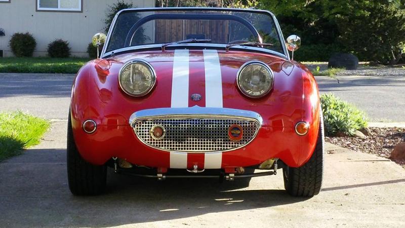

bugedd
I have the Moss offset upper trunion bushings, work out quite well. Should be able to see the negative camber in the pic, just barely.
