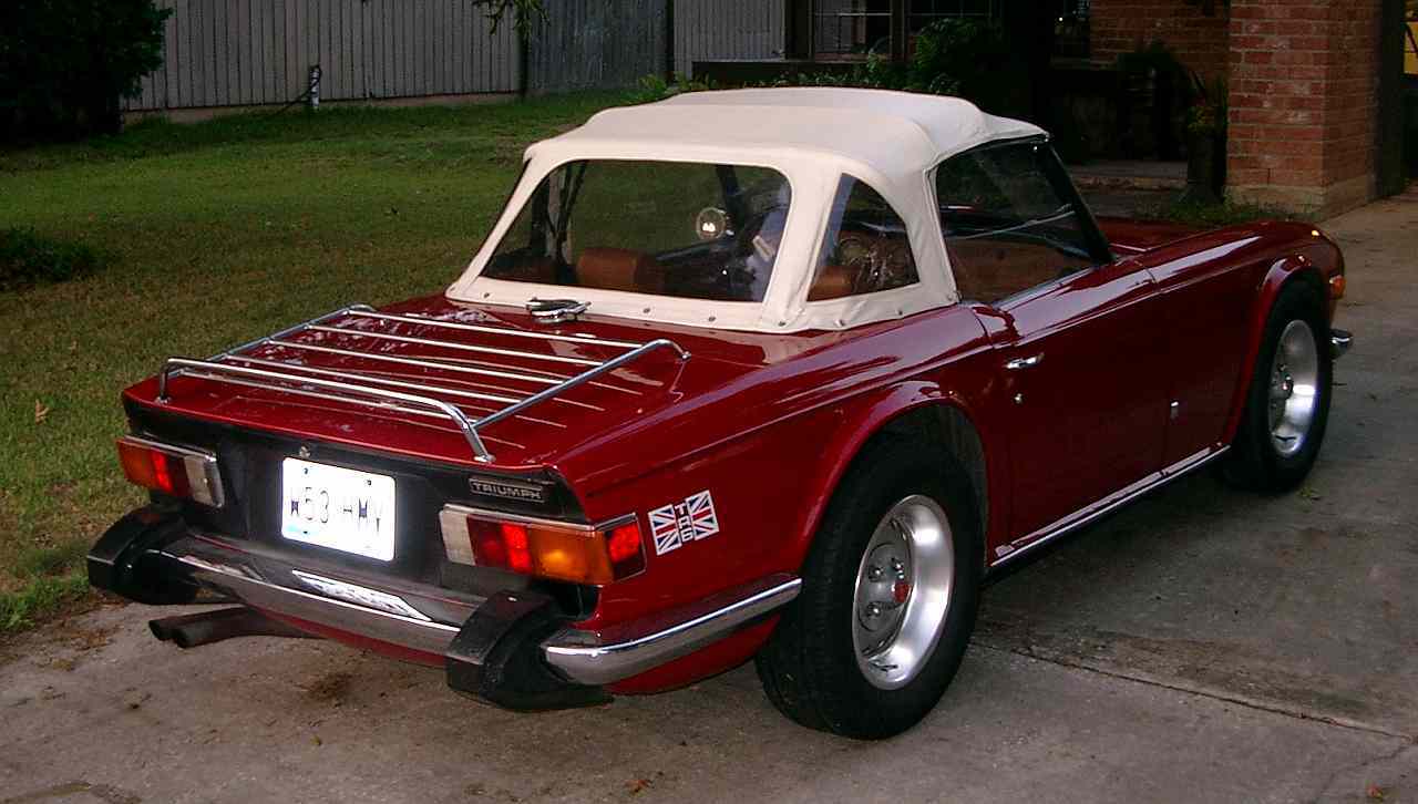

Careful what you wish for. My previous top went up and down with almost no effort -except the frame was so loose it took 6 hands to move it into latching position. But when it was up, and driven at highway speed, it raised up, flopped around and was very noisy. The one I have now goes up easily when about 80 degrees, but is a pain when cold. When I drive with the top up at any speed or temperature, it is quiet, and always looks nice and snug. Living in Texas I generally let it down -the worst thing to do to a top for shrinkage. Today I put it up in the garage and it's been cold lately (in the 60's) because I plan to drive it this weekend with a 80% chance of rain.

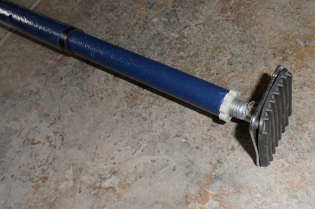

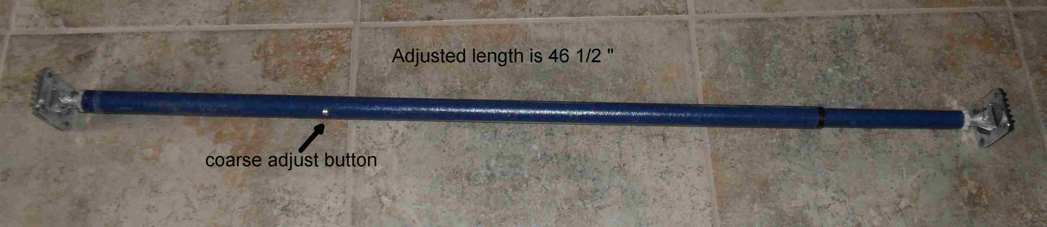

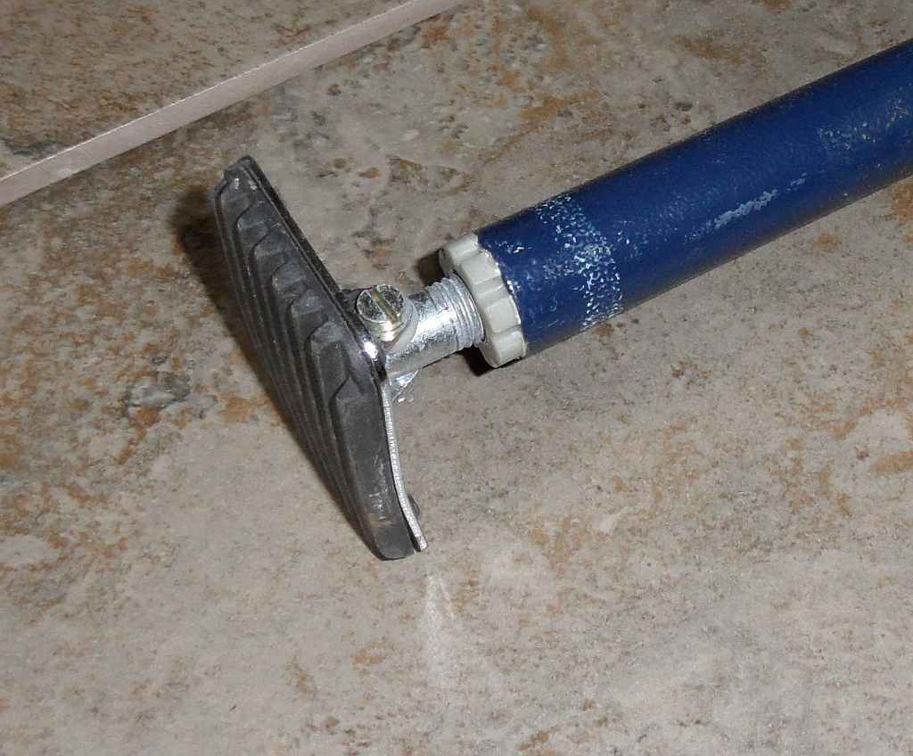

I should mention my trick. Harbor Freight has a "cargo holder" or something intended to be used in the bed of a pick-up truck to keep the load from moving too much. It has rubber blocks on each end and can latch to several lengths (for different truck bed widths). It also has 'turnbuckle' threads at each end to allow turning the rod to lock it into place. It happens to fit nicely between the rear deck of a TR6 and the center of the top frame above the windshield. A few turns and the top can be latched without assistance. I am careful to not stretch it too much, but have no idea what it will take to tear.

New or not there is a big difference in the quality of tops on the market today.If you have a cheap one you now know why you should invest in quality...
The tr6 is about the easiest top you could ever have to install so as long as it is (fairly new) a good quality top goes on in a snap(if you have a snap tool).
Use a good contact adhesive to baste the top to the header after it is well fastened int the rear and sides.Pull it fairly tight ,the latch it and check the fit.the adhesive will let you fine tune for several minutes(3M black weatherstrip)when you have it right then you rivet on the seal retainer and install the front seal.
If you replaced the webbing you will have several more things to fiddle with.
MD(mad dog)

That's not exactly what I have -though it may work. I'm sure the ones I have came from the local HB store a few years ago, and were on big sale, so perhaps they were on clearance too. I can't find it listed now. Mine has spring buttons to fit in holes to adjust for largely different lengths, and the screw ends to snug it up. It's the same as a basic shower curtain rod.
I think I post more pictures than anyone, but how many words they might save.
P
