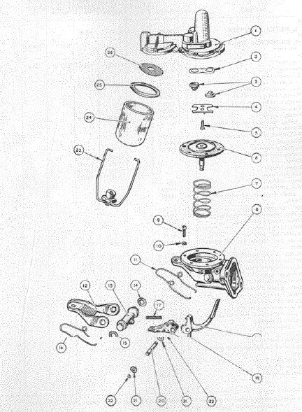

FWIW, Triumph never fitted electric fuel pumps to any of the sidescreen cars. In fact I believe the only sports cars to have electric fuel pumps are the PI, TR5's and 6's, and this is because you need a high pressure at the injectors.
Your car would have had an AC mechanical fuel pump. When properly restored, they are very reliable and they add the convenience of priming lever and sediment bowl.

Andrew Mace
:iagree: However, electric fuel pumps often were "recommended fitment" on competition cars, for whatever reason. My Spitfire 4, a virtually textbook example of the original Spitfire Comp. Prep. Manual, still has its Bendix electric fuel pump in the boot as per the Manual's recommendation!
