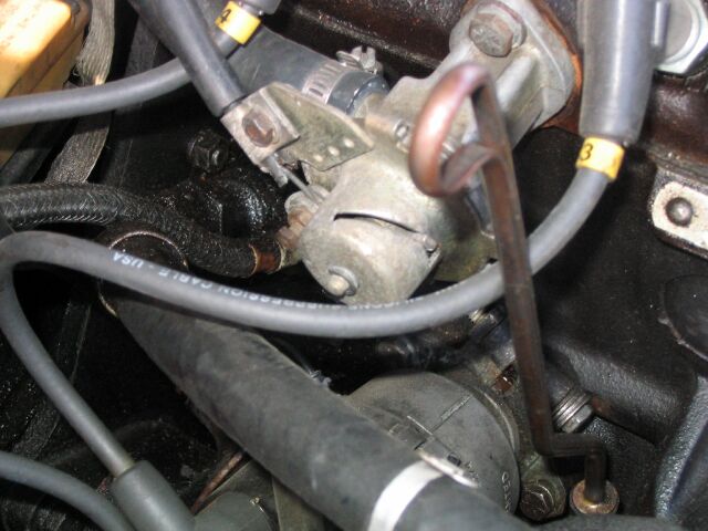

77MidgetMkIV
My 77 is the same. It is a lever arm faucet type valve. Mine is located toward the rear end of the valve head on the left side of the heater box. I will try to attach a photo of mine

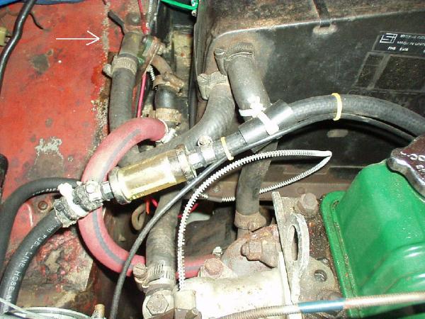

jaybird
Found a thingy under the hood that sounds like what you have described. (see attachment) It was in the forward position. Looks as if something has broken off it.
When I moved the control on the dash, seems as if it doesn't want to open that thingy. Moved it manually with a pair of pliers to the back position. It's 60 degrees here today, but I'll take the B out tonight and see if that solved the problem. Thanks!
Joe Reed
You found it! And you're right, it is in the closed position in that photo. If it stays open, you should feel a little more warmth - at least on your right ankle. Sounds like you probably need a new cable....or just keep turning the heat off and on manually /ubbthreads/images/graemlins/laugh.gif - that's what I'm doing right now...until I get in the mood to replace my cable. If you have trouble keeping the valve in the position you want, you may want to loosen the cable clamp and slide the entire cable - sheath and all - one direction or the other to force it to hold the valve where you want it. In the case of my car, the cable won't budge in the sheath, so I just use it to sorta clamp the heater valve in position.
