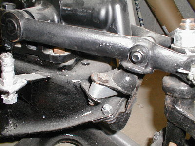

Tom Rynne
I followed the directions included with the Brit-Tek kit and reversed the aluminum spacer. You have to cut it in half and then bolt it under the topside of the buffer assembly. This is the front axle which is going onto my V6 car.

aaaahhhh! I thought I remember seeing something about moving that spacer to the top, but seeing the size difference made me question my memory. Thanks for the pointer! /ubbthreads/images/graemlins/smile.gif

I relocated my front bump stops this weekend by moving the space block to the top (ala Tome Rynne's post above). I gotta say the extra small amout of extra clearance that gave my suspension made a world of difference in the ride.
