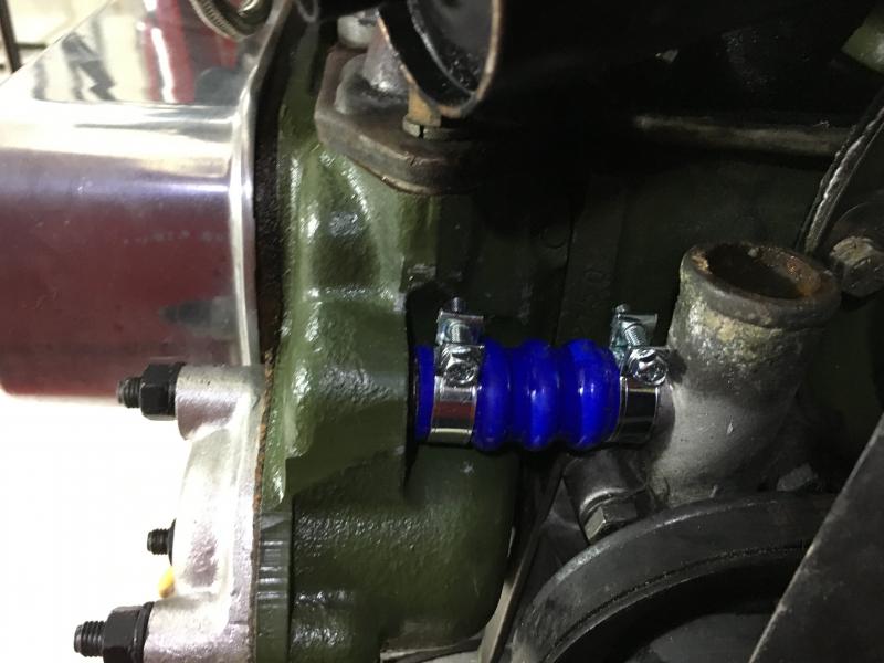

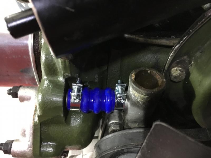

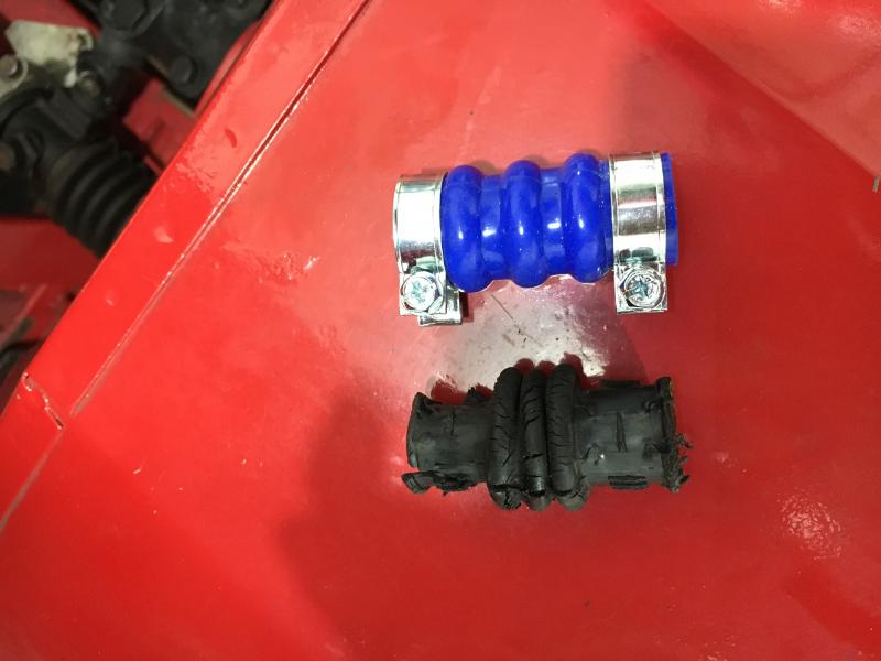

So I finally made time today to change the bypass hose .
i didnt even try and do anything without removing the radiator.
glad I did it actually went really well.
my advise to all that are putting this hose in is don't get the rubber one from the usual suspects .
they are truly aweful my guess is that if your a driver the hot dry air rots these at an excelerated rate being in direct air flow.
im sure all the miles I put on it in Texas didn't help but wow this hose and the top rad hose on the bottom side are toast .
if your going to drive yours as I do mine I suggested getting these silicone hoses.
i know its Blue yuk color but the upper and lower are avaible in black.

The one you replaced looks like an original. The cheapo replacements are not nearly that nice unless they have changed. The one I had fail had no fabric at all in it. The silicones look like they will do the job!

I bought that hose from moss about April 2000
only lasted 16 years horrible ! :wink-new:
It's just in a nasty spot and with this in there going forward its going to be some one else's problem.
