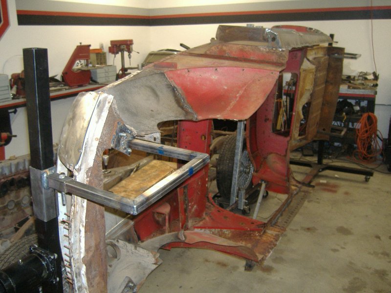

Here's my take on a rotisserie that will take a variety of LBC bodies depending on the adaptor arm design. Similar to Ray's but built from scratch with the idea that it will break down for storage when not in use. https://www.britishv8.org/Articles/Auto-Body-Rotisserie.htm
It's also tall enough to allow complete rotation of the body. Here's my MGA mounted on it.

Here's a couple pics of how I did my Sprite rotisserie. I couldn't find any photos of how the rear was attached, but if you look at the stand, you'll see that it mearly bolted underneath to the spring shackle mounting holes.
My Sprite was on this spit for 10 years and finally is now on jack stands. It's been primed and awaiting paint.
The rotisserie was a wonderful tool during the time when I was cutting out rusted metal and welding in replacement parts.
