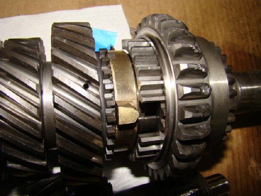

Pete3000, I'm also rebuilding my BJ7 centershift transmission. The reconditioned laygear from AHspares looks to be good, that's what I'm buying. Be prepared though as they require a clean exchange part. The laygear cost me $48 to ship to the UK, and THEY ARE SLOW in responding. I purchased a used transmission from a local club member and got a good 1st gear, with sliding hub, plus reverse gear and any miscellaneous parts I might need. A new 1st gear with sliding hub will cost you $700 from most US suppliers. I thought it was too expensive for a gear you'll hardly use so I went the used route.
Bet my 1st gear and reverse are worse than yours???

Wow Johnny, that's pretty chewed. AH spares shows to have 1st gears on their website for around $350 with sliding hub. They also have just the first gear outer only. Is there a reason to buy the assembly and whats the advantage over just the first gear outer only?
I would be hesitant to order the outer gear only, for fear of it being even the slightest bit off from your existing inner gear. If it doesn't have an EXACT match, you're going to have trouble shifting between 1st & 2nd gears.
I'd recommend getting the whole assembly for a match.

I know AH spares shows the outer gear only but, it's no longer available ( I checked). Be careful, I think that gear for $350 may only be for a BJ8, double check before ordering. Moss sells (same for British Car Specialist) a complete 1st gear plus sliding hub for $700 which is about the going rate for a new gear. BCS did offer to send me a used outer 1st gear only, but as Randy points out, it may not work right. The high cost for a gear you'll hardly use does seem pretty high, that's why I bought a good used transmission and am in the process of transferring parts over. I'm buying a reconditioned laygear plus synchro's from AH spares.
With the high cost of rebuilding a transmission I now know why a lot of people are upgrading to a Toyota conversion kit.
