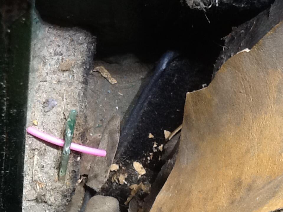

I got the softtop out to fit the hardtop
It is where the pink wire is sticking through

In that case I have a problem! No tab!
obviously missed out at the body shop.
Thinking caps on to try and come up with a solution.

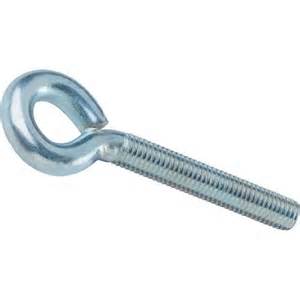

Yesterday I purchased a couple of eye bolts to fabricate a floor hook if need be.
Planning on attempting the installation of the folding top next week which I am not looking forward to.

As original a tab is welded to the side of the side rail. The spring hole extends above the top of the rail about a half inch. It is very hard to attach the spring since you have to deal with spring tension. You also need to position the spring so it doesn't interfere with anything when the top is raised and lowered.
