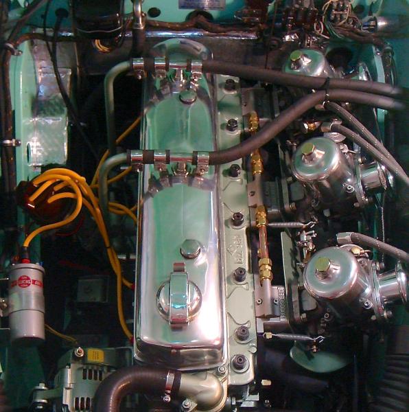

I ditched the bumblebees years ago, always were a problem with the Pertronix. I run Accel Spiral Core Wires in a similiar yellow color, https://express.google.com/product/...pping&utm_medium=product_ads&utm_campaign=gsx
A little lacquer thinner removes the labeling on the wire, so they still look period.

YES I quit the bumble bee wire too and use yellow EXCELL wires.
The Bosch Blue coil was always used in the Late Volvo P1800 cars and it outperformed the old Healey Lucas sport coil and did not leak.
To control EMI I use Resistor Plugs and plug caps, the side entry distributor caps with the screws are potentially susceptible to corrosion and may have cause a problem However , I have never given up on the side entry cap.

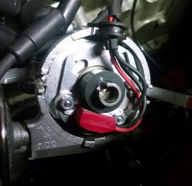

Went ahead with my original plan for the 22D - installed a Pertronix II. In light of the calverst.com article above re misfires - the design with the separate module bolted to the base plate makes it easy to add a dedicated ground wire going from the module base to the chassis at the coil mount. For the ground, I used a leftover piece of Pertronix' fine-strand black wire, spliced to a different color wire outside the distributor.
FWIW - I installed the disty in the same position as it had been with points. It started OK, and at idle, timing light showed about 40 degrees advance.

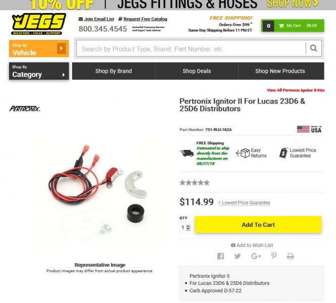

Hmmmm ... Pertronix doesn't seem to list any units for 25D6, as used on BJ8s. Have they been discontinued?
Well:
If you have a pertronix unit in your car just about any other six cylinder dizzy module of the same ground configuration will work in your BJ8 dizzy.

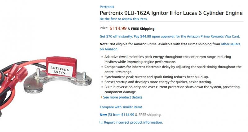

Both ads imply the II is for negative ground only (assumed, I guess, if for positive ground they indicate it). Anyone know if there's a II for pos. gnd.?
Steve, these show only two leads, did you add a ground lead? If so, why?

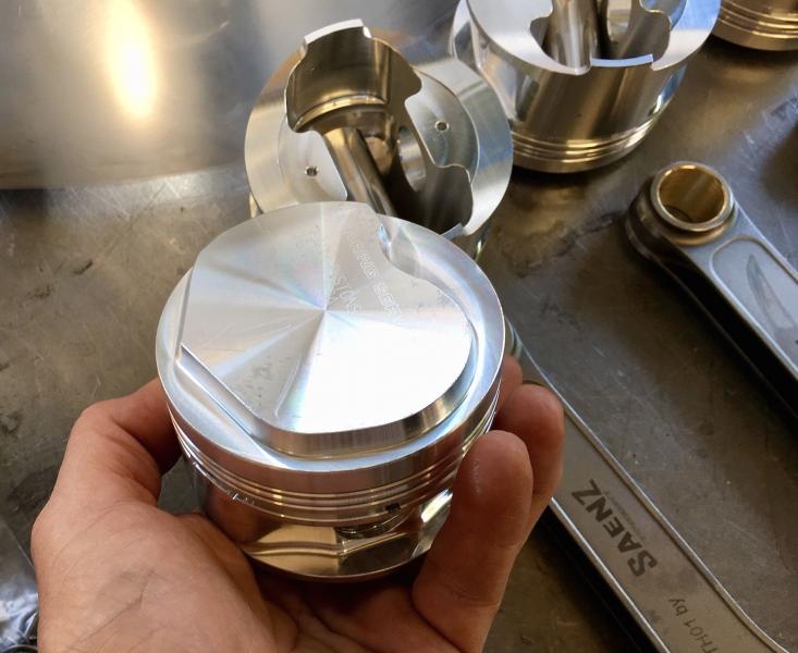

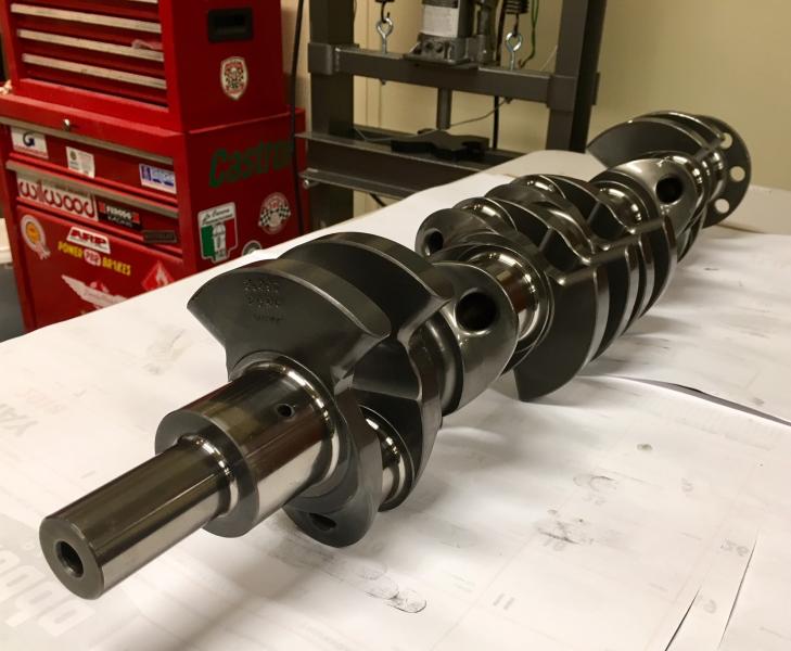

Good grief Dougie! You need to warn us before you post stuff like that, what if our wives walked in?!?!
Those pistons though. And that crankshaft! If I'm going to dream of a fantasy, those pictures are as good as any__and better than most :cheers:
