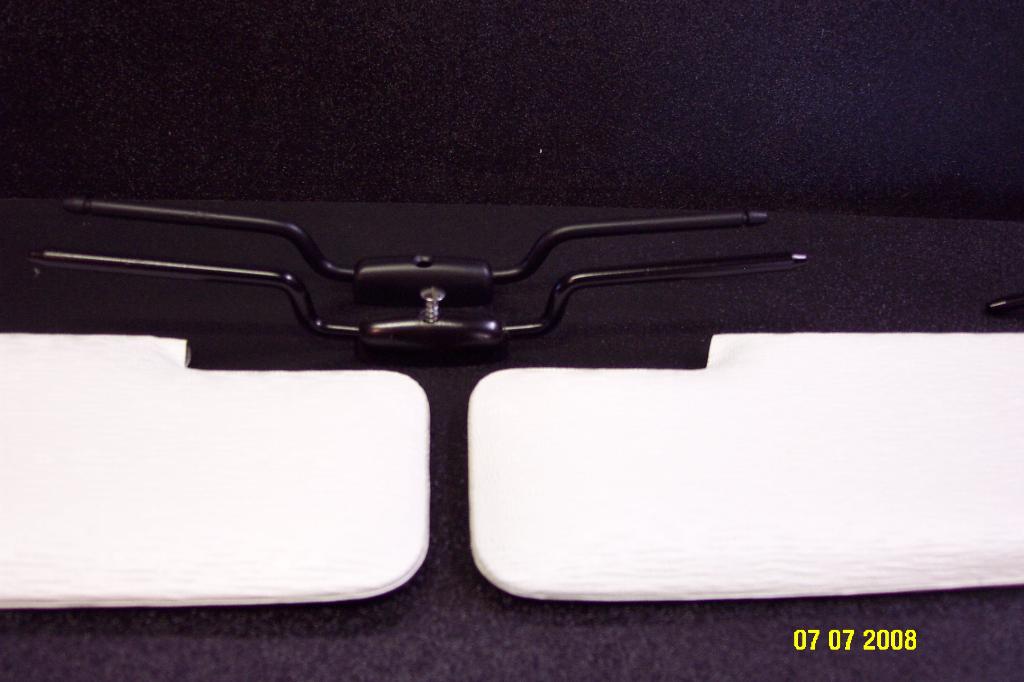

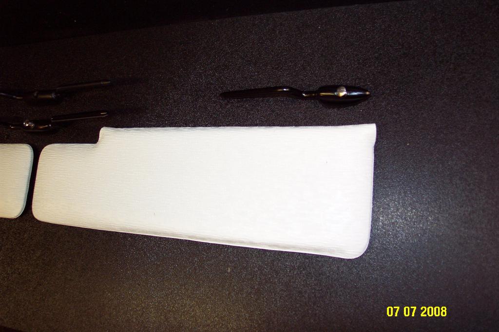

2. Would anyone (please) be able to snap a couple of detail photos of the centre and two outside mounts of their sun visors?

The center mount for the 4A has a slight dogleg on each end. I have a set in my shop that I will post for you to look at.
PeterK
Our 4th vistors just left so I had a chance to snap a couple of pics for you. Sorry it took this long.
Notice that there are 2 variations on the center mount at the end that slips inside the visors. Both are from 1966 TR4As. The flat finish is correct.

Good thing I got lazy this morning and didn't take any photos - I can't improve on Peter's shots, I have the same setup with the center piece not having the extra notch.
Peter- did you redye those visors? If so can you point me to what you used? I have a pretty good set to refurbish but they definitely need dyeing.

They're nice aren't they?! Foam was in great shape. Many of the original visors are "sagging bags of slop" to quote Charles Runyan (TRF), because the foam got wet and degraded.
I washed them with Westley's Bleech-White and a soft brush being very careful not to let the foam get wet AT ALL.
Then I used SEM Vinyl Prep #38343. Wipe down and let dry. Then SEM Color Coat (a soft vinyl paint) #15603. It's a very close color to the original. Not too white, not off-white or beige, but "sailcloth" describes it well. Too often I've seen black used but I think that black wasn't offered until the 250s.
The "proper black finish" on the brackets (the one with the notches) is not satin, and not flat. It is a Krylon color Semi-Flat black. I think that it's also just right.
So now everyone knows my secrets. The hard part is finding the visors in the original pattern and the brackets. Both are NLA AFAIK.
