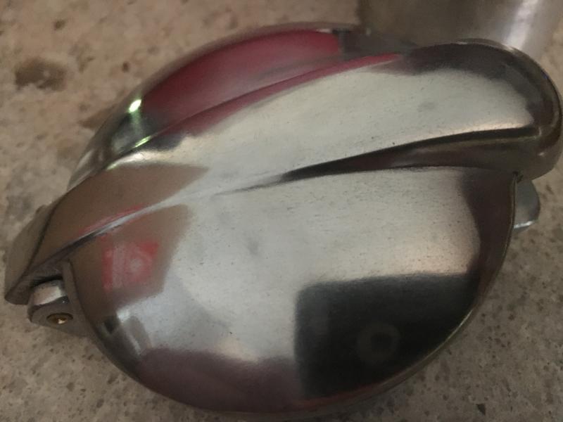

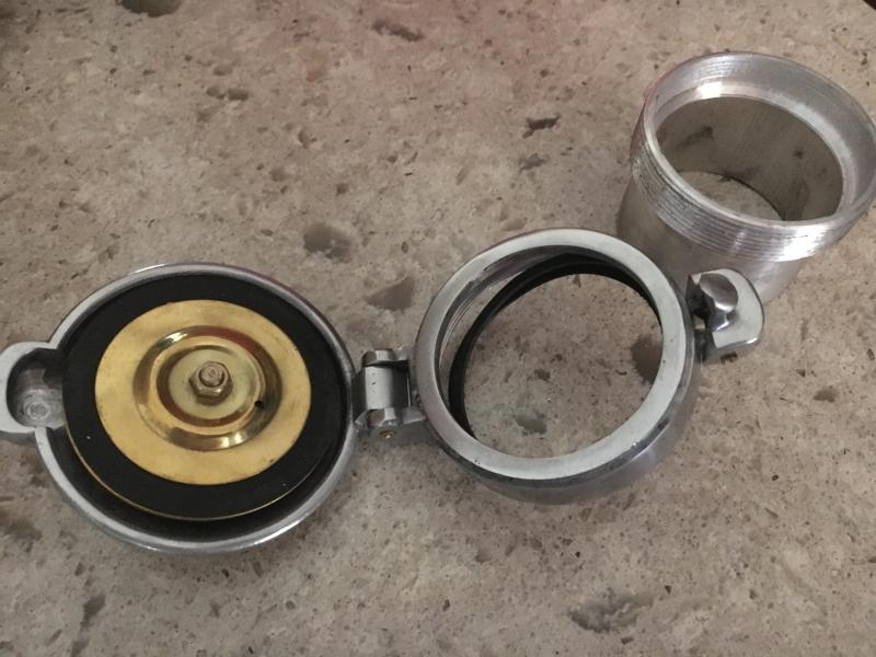

This is the one I got from Denis Welch. The collar fits around the filler tube. I epoxied mine in place, then drilled and threaded through the collar and tube for a couple of set screws. The cap is threaded on the collar and the set screws are installed from the inside so the cap can't be easily unthreaded. It sits down on the rubber grommet.

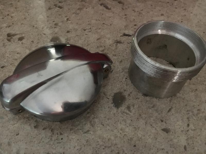

Ok it arrived from India , took just over two weeks so not bad shipping for free .
Quality of part I will give it 7 out of 10 .
Considering it was only 40$ CAN I thinks its ok .
Now the issue . It was listed as a 2 1/2” cap and I took that to be the ID of the collar so it would fit directly over the filler neck tube once the old adapter part was cut off ......Wrong .....the 2 1/2” is the ID of the threaded section that the cap screws onto .
Anyways the actual size of the cap is very similar to the old flat originals so it doesnt look bulky so I think I can make it work by cutting off the old cap adapter off the filler neck and then using a second rubber hose connector under the body ,the new collar will fit inside the rubber and then the rubber will connect to a shortened filler tube to the fuel tank .
On second thoughts Im going to get a piece of 2 1/2” tube from somewhere , exhaust pipe or stainless tube etc and use that instead of cutting my original .

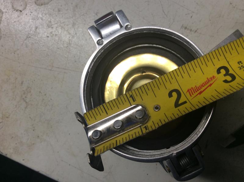

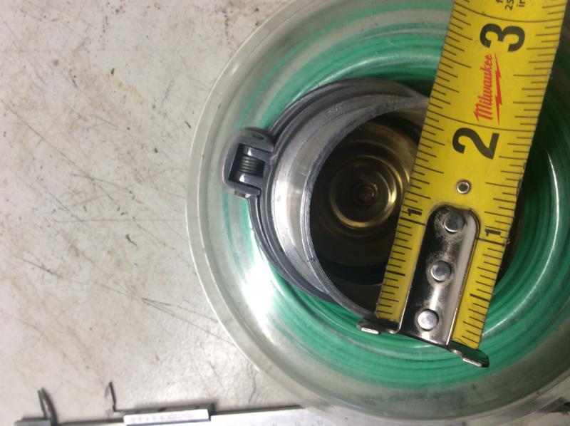

Not a hope its 2” bore on the ID of the adapter, fill tube is 2 1/2” OD .

Ok I Will try this again .
The collar (adapter) has a 2” ID ie inside diameter ....all the way through so there aint no way its going to “slip over “ a 2 1/2” pipe .
I did take photos with a tape measure in the pics .

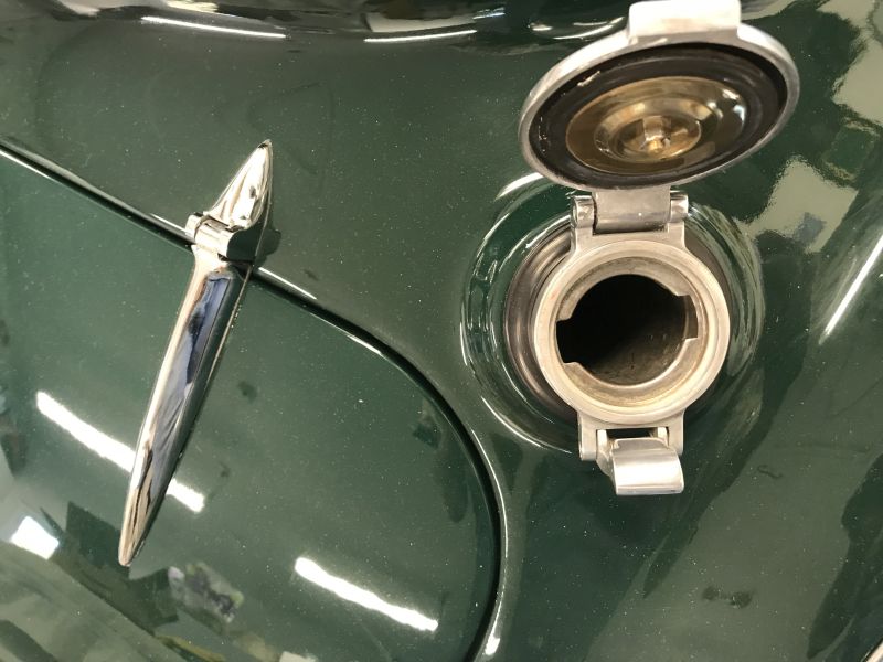

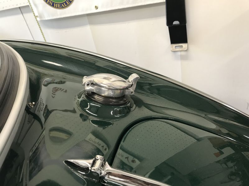

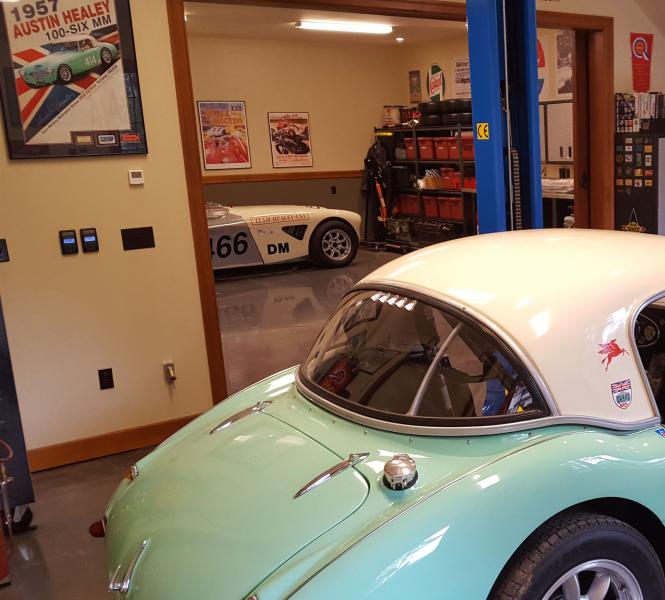

They do look great when done right....

Healey Nut - you evidently have the weld-in adapter and need a different adapter to fit your stock filler pipe; your cap is the correct 2.5" size.
The importers of British Aston and Monza caps have a pdf with all the dimensions, including the collars. They also sell the brass ring you can install on the outside of your Healey filler. Download here:
https://mocalusa.com/aston.htm

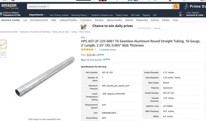

So I went to my local auto store and got a 18” length of 2 1/4” exhaust pipe that is swaged at one end ,the original filler pipe fits inside the swaged end snuggly . The collar (aluminum) that came with the cap is slightly loose in the swaged end .
Im going to reduce it with some careful hammer work then epoxy the collar into it .
I will then cut it to length and install it to orient the cap where I want it so it doesn’t hit the body etc when open .
