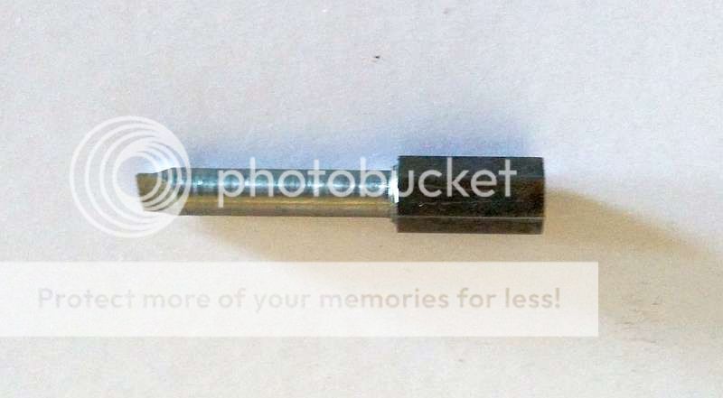

One tool I've found useful in similar situations is a "hand impact tool" https://www.northerntool.com/shop/tools/product_36882_36882
Mine takes 5/16" hex bits, so it's fairly easy to fashion a custom bit from a 5/16" Allen wrench. Here's the one I made for some tiny plugs on an old tractor carb last year:
tool.jpg~original
Try to get the tip to be a snug fit in the slot, as that lessens the chance of stripping it.
I forgot to take photos of the little ones, but here's a shot where you can see one of the bigger ones. Some of the little ones were down holes (which is why the tool is so long). I couldn't budge any of them with an ordinary screwdriver, but all but one came out with no damage using the impact tool and custom bit.

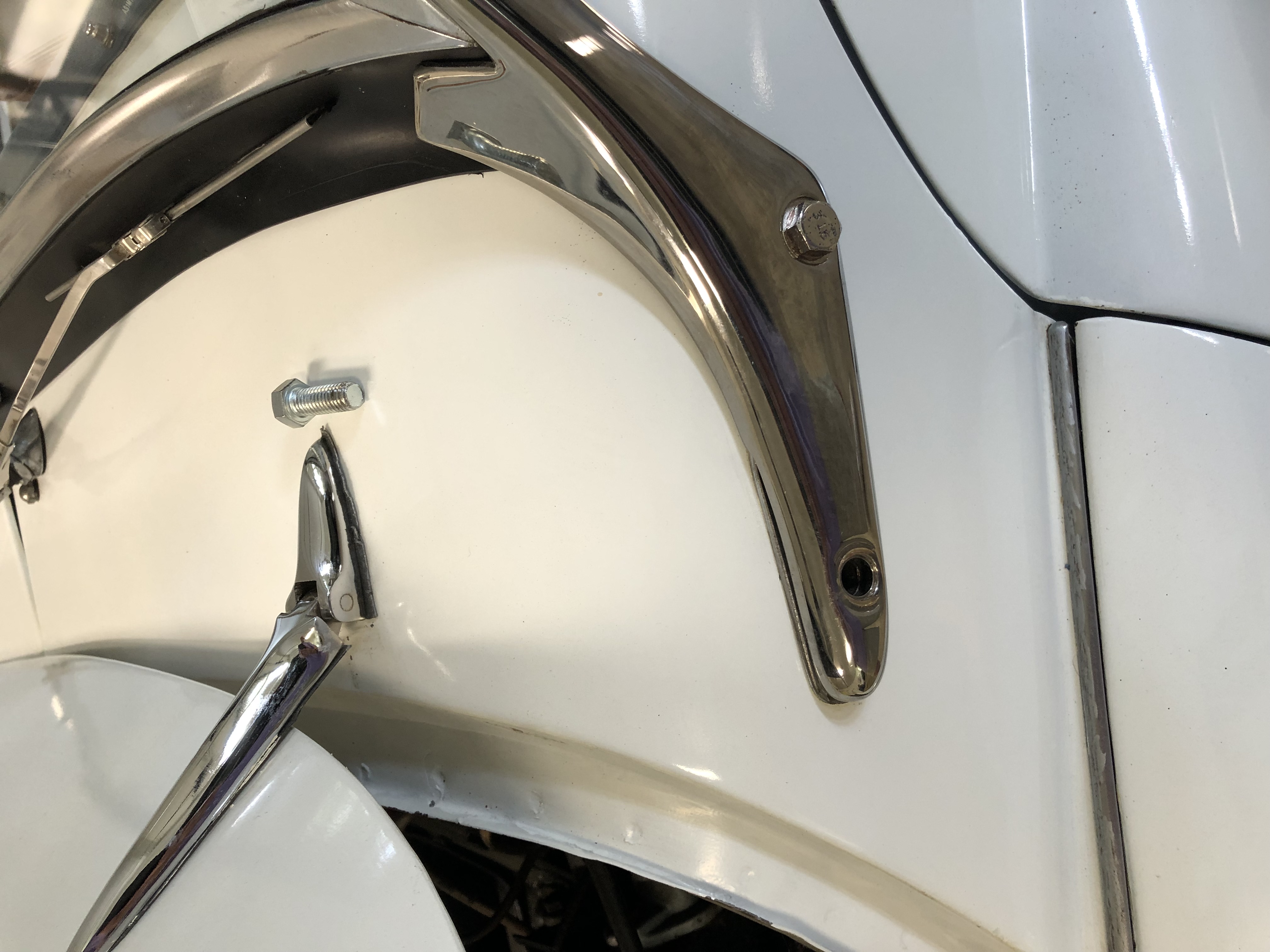

Question (I think I’m screwed🤪): how do you retrieve the “captured” bolt inside the cowling on a TR3A that receives the bolt that holds the windshield stanchion on the guide plate? One of the two that hold my left stanchion to the guide plate apparently came loose and dropped “who knows where.” See attached photo.”

charleyf
From inside the car at the top of the foot well is a metal panel that covers/hides those welded on nuts.
If I were in this situation, I would locate where on that inner panel is directly behind where the missing nut was. Maybe a long drill to do that. Then I would create a hole large enough to be able to insert a replacement nut and a socket to hold it. Remember to take into account any angle so you are working at 90 degrees from the outer panel.
Use a new nut . Unless you want to dismantle your car there is no sense looking for the old nut.
Charley
sp53
Interesting I have never saw a set up exactly like that where there is a bolt and not a screw. The bolt looks chromed and stock. In addition, I never saw the guide plates using thread bolts and not using dzus fitting which screw to the body to slide the windshield in place.
I had a 1961 where the windshield simple screwed into the body with screws like you see in a Moss catalogue without a guide plate.
I traded some guide plates to a guy in Canada because I could not figure out a way to use them. Is the car a 1960?
Charley’s plan seems to me the only you can fix it and should work fine.

Donald1107
It is a 1959. And thank you, Charlie, for a good idea. I was considering a KeenSert thread repair insert. But I like this option to go through the inside panel.

mrv8q
Not that it’s helping, but I’ve never seen bolts used there, only Dzus fasteners or screws.

charleyf
The change must have been somewhere around TS50000. That is a wild guess. I do know that the last TR3Bs were built that way. These "bolts "are chromed and are likely called shoulder bolts.

Donald1107
This worked great. The space between ‘em the outside guide plate and the panel inside the driver’s foot well was only 1 1/2”, and I could put a 3/8” drill all the way through. So a 2” course thread bolt with a large washer and nut holds the stanchion firmly to the guide plate. Thanks!!!
