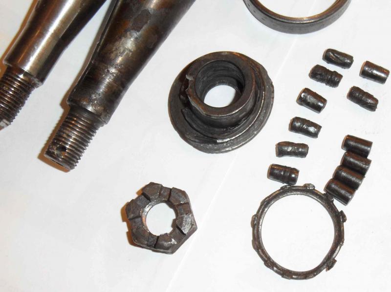

This morning at breakfast I got to see the TR4 workshop manual including the picture of a dial indicator but no explanation or indication of what the bearing end-float should be. It seems in reading elsewhere, there should be no pre-load, and the end-float should be between at least .001, to .004 or .005 depending on who is defining it. Since we had no other dead horses to beat we decided to do a little math...
The threads on the end of the shaft and nut are 20 threads per inch. The castellated nut has six sides or flats, each with a slot to fit the cotter pin. The axle end has two holes drilled at 90 degrees to each other. This allows the nut to have 12 different positions per revolution to insert the pin, since each 1/2 flat exposes a hole.
1/20/12=.004 It seems very possible to get the end-float pretty close. Even with the seal not installed, I guess this measurement must be done prior to grease added, or the measurement could be way off. It seems to me that either method of setting the float will result in the same setting.
We have a club member who has put over 100,000 miles on his TR3 and works on many TRs. He has never used nor heard of anyone using a dial indicator to set end float. Then again, he never replaced a stub axle or had a bearing fail like mine has. Maybe some of us are luckier than others -and after looking at my D-washer and inner race, he thinks I am the lucky one. Maybe you've got to be very lucky to drive a TR3 until a wheel falls off.

I've not personally had a wheel bearing failure that had grease in the remains. Of course you could argue that a bad bearing heated the grease and it burned away causing the failure and I guess that's plausible.
Like your club member I'm one of the lucky ones, I guess. I do have a dial indicator but have not bothered to use it on front wheel bearings. Perhaps not too late to start.

Back in the 50s and 60s I worked on quite a few non British cars and the nuts on the spindles were tightened up until snug, spun the wheel and snugged up the nut again, then backed it off until the next split pin hole lined up and that's where it stayed. Never had a bearing failure in all those years. Of course these were all tapered bearings. The ball bearings in some of our cars are a different story, as the center race must be held in a position so no side load is present in the bearing, reason for the spacers and shims, plus factory torquing specs should be adhered to. On a ball bearing, those who don't use the proper spacers and shims are asking for problems down the road, literally. Ball bearings are only designed for minimal temporary side loading, as in cornering. PJ

Back in the late 60's through late 70's, one US brand recommended (and we were taught at the dealership..and I still do it) to use a BIG Crescent wrench, spin the hub/rotor in direction of tightening, and tighten is almost as hard as you can with a 14-15" Crescent. This makes absolutely certain the races are seated in the hubs, and any stray grease is pressed out of between races and rollers.
Then back off 1/2 turn or so...then put your pinkie in the hole in the end of the wrench, and pull it down tight until it stops. Set the stamped steel castellated piece onto the nut, and pin it.
Never had a failure, and I've done thousands and thousands.
I have a big problem with that in my background setting up for "end float"..even my Jag has "end float".
But, if I have an issue and cannot get it better than too tight or too loose, I swap the nuts left and right.
They are never exactly the same start point for the threads compared to the key slot.

What DOC said, I was taught the same thing. I have never put the miles on a tr3 at one time like you do TexN and driven through those deserts, to me that means a lot. Hard to say what went wrong, my first guess is somehow the bearing got dry and you know the rest. I will say, I will check my bearing out before I drive to Idaho or something, because I usually never think about them after I have done the grease them up tighten them up hard and tight and back off that fuss. Anyways keep on trucken and doing your runs they are cool and I will/might try it myself someday.
