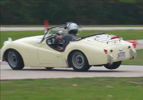

Anyway, I thought I'd share this picture taken last week at our club autocross at the police academy. My car was in good form and I feel I drove it well -even if the police Explorer beat my time. As an extra bonus this year I did not need to be taken home on a flat bed. Actually, for Easter, I plan to pick up my wife at the airport, in Pittsburgh Pa, in the TR3. According to Google, it's 1,350 miles from here so I will leave earlier than she does. The odd thing about this trip, is this time I think the car will make it without any problems. The odometer shows I've put a little over 20,000 miles on it and I think it's done breaking in. -I don't know what might break next, but keep me in your positive thoughts.

Hey Jerry, have a great TRip and drive safe!
Cheers
Tush
2long
Nice picture - love the sense of g-force lifting the wheel off the ground! Way to use the car the way it was meant to be used.
Dan
Jerry, if you need some car connections when you get to Pittsburgh, let me know. I am a transplant from there and now that I live in Chicago, I knows a guy what knows a guy.... :smile: Safe trip and remember - without pictures, it didn't happen!! :D

Have a safe trip and keep all 4 wheels on pavement! That is a cool shot there!

That picture was extracted from a digital camera shooting about 30 frames per second. Since 8 of the frames clearly show the wheel in the air, I was three wheeling for about 1/4 of a second. Trying to time that photograph is very unlikely. It's odd that the video taken from my GoPro mounted above the windshield barely shows any body roll, while the video taken from the spectators view, shows a lot. The amount of force on the front left stub axle has to be significantly higher than normal. If I didn't have the picture(s) to prove it, I wouldn't believe it.

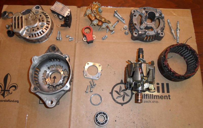

Here is a picture of the alternator taken apart. The only thing I can see with any issue, is the front bearing has seized. That little washer above it is all that's left of the front bearing seal. The rear bearing spins freely. Interesting to note are the fan blades on the front and rear (internally) -and it has 8 diodes/4 coils. I ordered a replacement bearing and will see if the unit functions properly after it is installed. Why would only 1 bearing fail?
CJD
Overloaded, overheated, or a manufacturing flaw...would be my guesses. Everything else does look really good!
