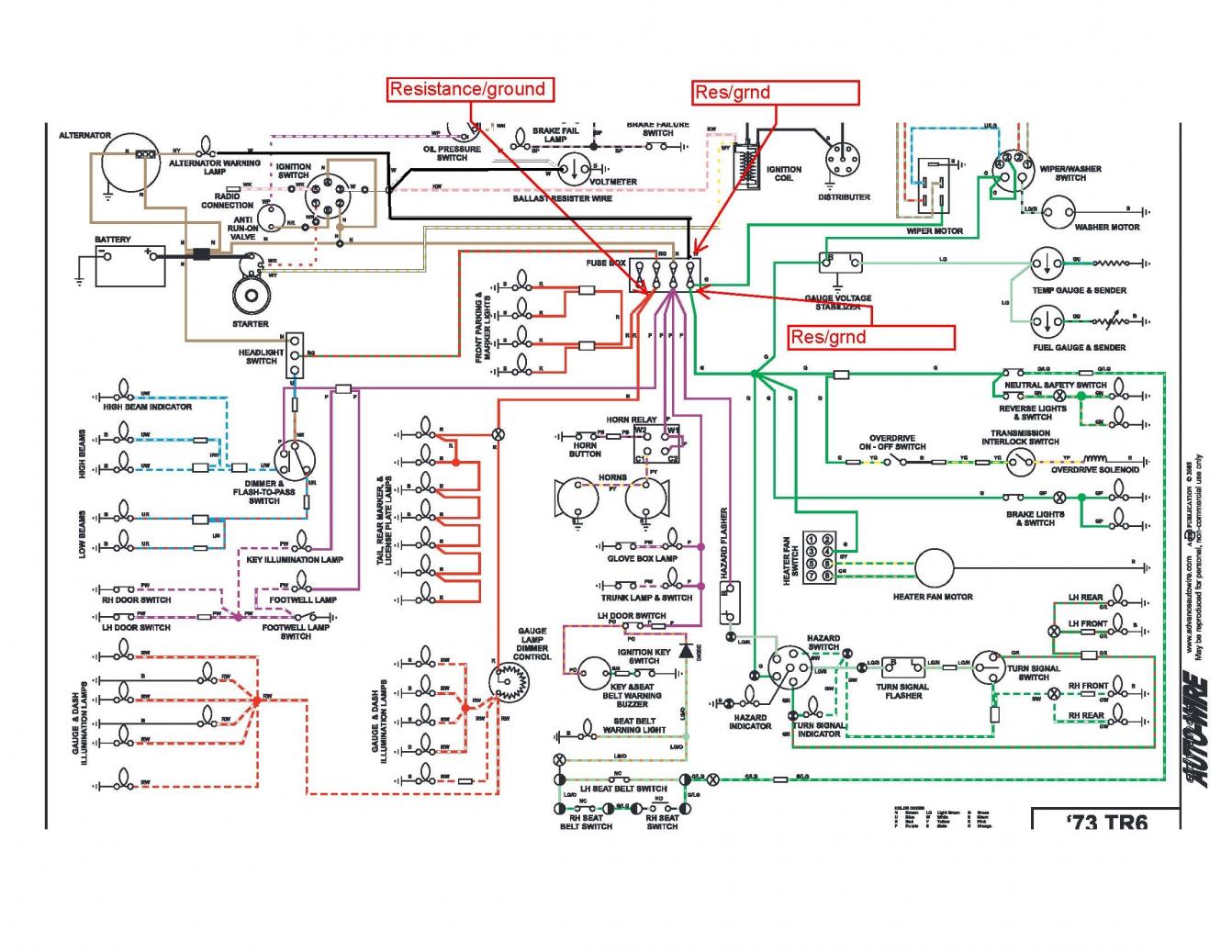

Back with another question, so I installed a new alternator which had bad diodes (according to bench test from Orielys) I assumed the alt was defective, returned for warranty exchange. Got to thinking, before I put the new one on, could it be the 73'tr6 that caused the blown diodes. The previuos Alt also hade a rectifier problem, I assumed it was age, as the car did not start when I bought it and had been sitting for 10 years. Now I am begining to wonder. Most all of the electrical in the car was functioning when I got it running and it was all original untouched. I have since had a few gremlins with turn signal relay and door/key buzzer. I fixed them and really have not had any issues other than instrument bulbs that are out.
So just to be sure I started to check all the wiring for corrosion or loose connections. The four spade plugs on the battery + terminal wire were pretty corroded and I cleaned them up. Did some ground resistance test on the fuse panel and found resistance at these locations. (See Pic) The other terminal plugs were open/infinite. Question being, should there be ground resistance at these points?
Additionally, the sense wire from the original Lucas alt had melted. I chased it back to clean wire and taped it back, since not used on new alt. Does anyone know where this wire originates from? Thanks-Brian

Yes, you would expect to find some small resistance to ground at those points. Basically you are seeing the loads on the circuit, which for the red wire will be all the tail and marker lamps. For the green, you're probably seeing the voltage stabilizer and gauges (assuming the points are open and the wipers/heater/turn signals turned off).
The corrosion at the positive terminal could possibly be causing diodes to pop if that is where the output wire (s) from the alternator are connected. If the connection was closed and then opened up with the alternator working hard. the output voltage might go way high before the regulator has time to turn down the current. Normally, the diodes should be able to handle that condition (known as "load dump"), but it puts a lot of extra stress on them. So if they are the least bit weak, pop goes the diode.
Many alternator rebuilders also say that you have to charge the battery first. IMO this is another case of reducing strain to avoid popping weak diodes; they should be able to handle whatever the alternator can dish out. But it's a thought.
I believe the small brown wire originally went to the connector hanging off the side of the positive battery cable. But I'm not at all certain of that. I'd try disconnecting all of them, and see if the small brown one gets disconnected. Another possibility might be at the starter solenoid.

Thanks Randall, The positive cable plugs were pretty corroded and I did have the new alt wired through the two brown wires in the circuit. I plan on running an 8awg wire direct to the battery for extra safety margin, so with this additional wire there really can't be a load dump can there? Only other wire on the alt is the voltage gauge light wire, is there a chance this circuit could cause diodes to pop?
Make sure the ground path is good as well. That's not usually a problem, but it might be. I had a case once where the ground strap bolt was loose, and the ground strap would alternately weld to the bolt, and break free from vibration. Didn't damage the alternator, but sure made it act funny.
An intermittent short to ground in this wire might possibly damage the diode trio (assuming your alternator uses a diode trio). But I don't see how it could damage the main diodes.
