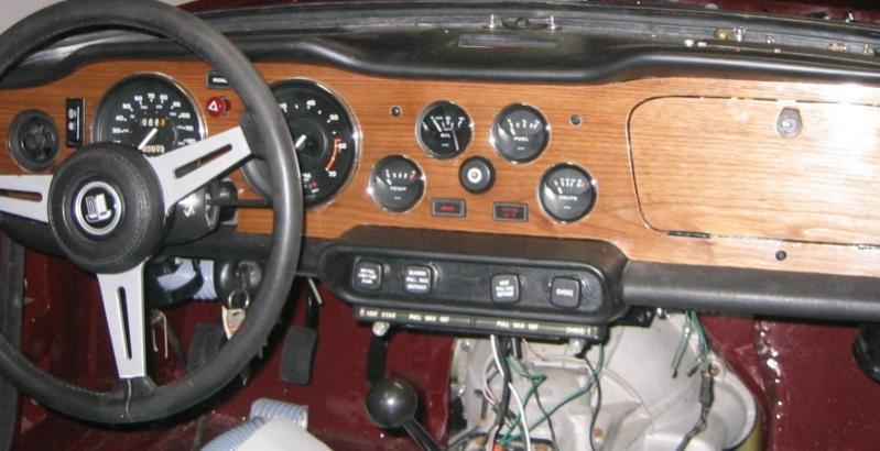

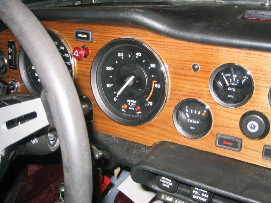

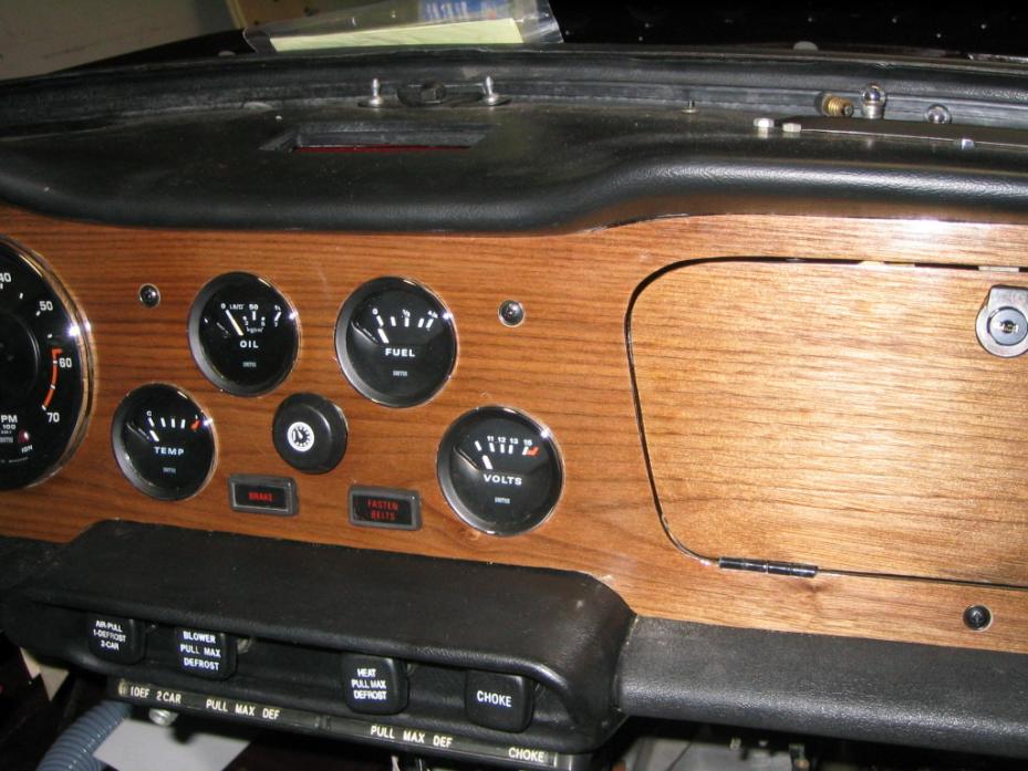

Here are some photos of the install... I think they matched up pretty good.

They do look nice, Elliot. I think I will try your idea of removing the studs and gluing them in again. You said you just used regular epoxy to do this? Any other tips?
Gliderman8
Here's what I did... I measured, then measured again before moving the stud to a new location on the crash pad. I used a string (because its a curved surface) to measure from the center of a hole where a stud fit into correctly to the center of the next hole on the metal dash. Then I used the string to transfer that distance to the back of the crash pad; drilled a small hole (careful not to go through pad!) and epoxied the stud into place after dry fitting first.
Gliderman8
Alternately, I guess you could remove the stud that doesn't lineup with the hole in the metal dash and press the crash pad against the metal dash and mark the hole from the rear. Do let us know how it goes.
