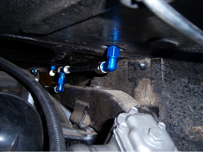

My fuel cell I had made (to my design...) would have worked perfectly but like an idiot, I forgot about the internal baffling when I decided to turn it front to back in the final stages. This was done to change the fuel filler location and I welded a new bung on the bottom forward corner for the outlet. Problem is that I had internal baffles welded in around the original fuel outlet that prevented fuel from sloshing away from the line. When my tank is full all is well, when low, aggressive acceleration or cornering forces the fuel away from the pick-up. I'm going to have to take it out and perform surgery on the baffling system.

I had the same problem of starving for fuel on hard corners with my home made fuel cell. My tank is baffled. I added another outlet on the other end of the tank, and tee'd them together under the tank so that the fuel now feeds from the center of the car. No more fuel issues.

My wedge does that on right handers when the fuel is below a quarter. Great Idea.

The M3 engine uses less than half the fuel supplied by the pump and it returns the excess. The only problem with two draws is that it sucks so much it'll pull in air no matter what if any supply is dry and that bubble will cause a miss. I'm just going to cut an access hole in the top and weld in a bent piece in the corner with a one-way flapper on each side so no matter what type of g's I put on it there will always be fuel at the draw point. Essentially boxing it in as a tank with in a tank.
