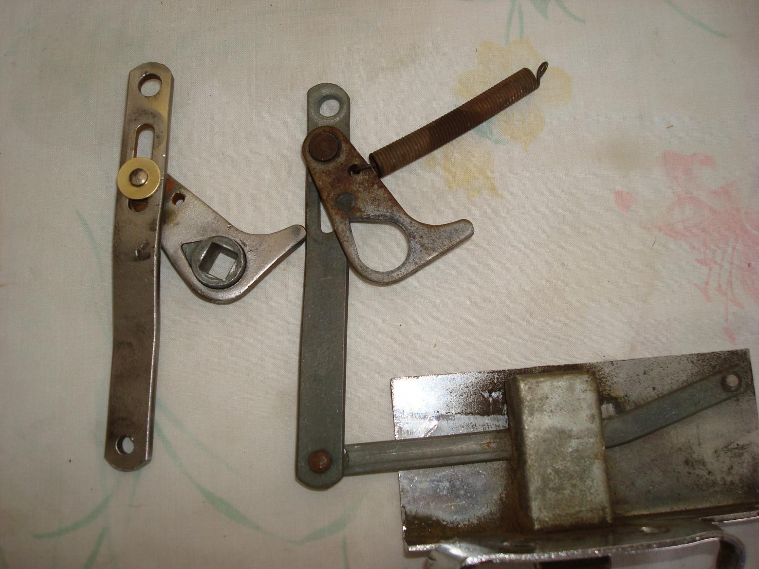

Dick is there anyway you can post a picture of what you need? I have a few old latches laying around but I'm not sure what you need. I know at least one of them has a grey pot metal arm and spring on it.

Hi Keith my picture poster isn't working and I 'm not sure why. It's the pot metal thingy that I need, but it has to be for the drivers side door because the pot metsl is handed. As you are looking at the part the drivers side pot metal thingy looks like a backwards L. The passenger side looks like a regular L shape. The rest of the parts are interchangeable.
Hope that makes sense.

I was afraid that what you needed was the gray pot metal piece. I have ruined several of them trying to get them off. They stick to the sq shaft. If you heat them they melt very quickly. I'm afraid I have to bow out on this part. Don't know of anyone that makes or offers them

Dick I think I have the part you need but I can't find my camera to confirm it. When I find it I'll post a picture, in the meantime PM me your address. Also the (L) shaped pieces I have are two pieces of metal spot welded together with a small pot metal piece pressed into it with a square hole.
mallard
Found it. The bracket on the right is for the right door, just the arm and (L) shaped piece on the left I think is for the left door. Unfortunately the piece on the left was missing the pot metal piece, so I pushed it out of the one on the right and put it in the one on the left, if that makes any sense.
