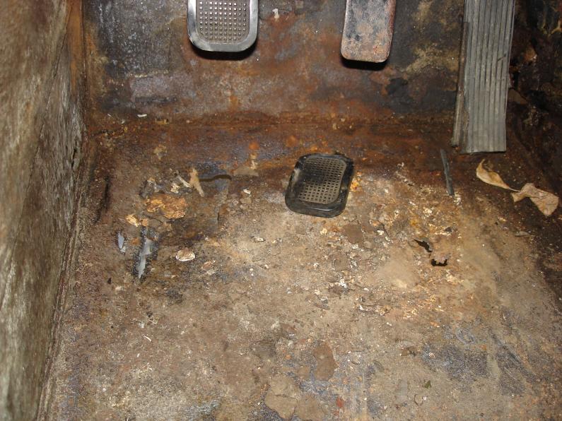

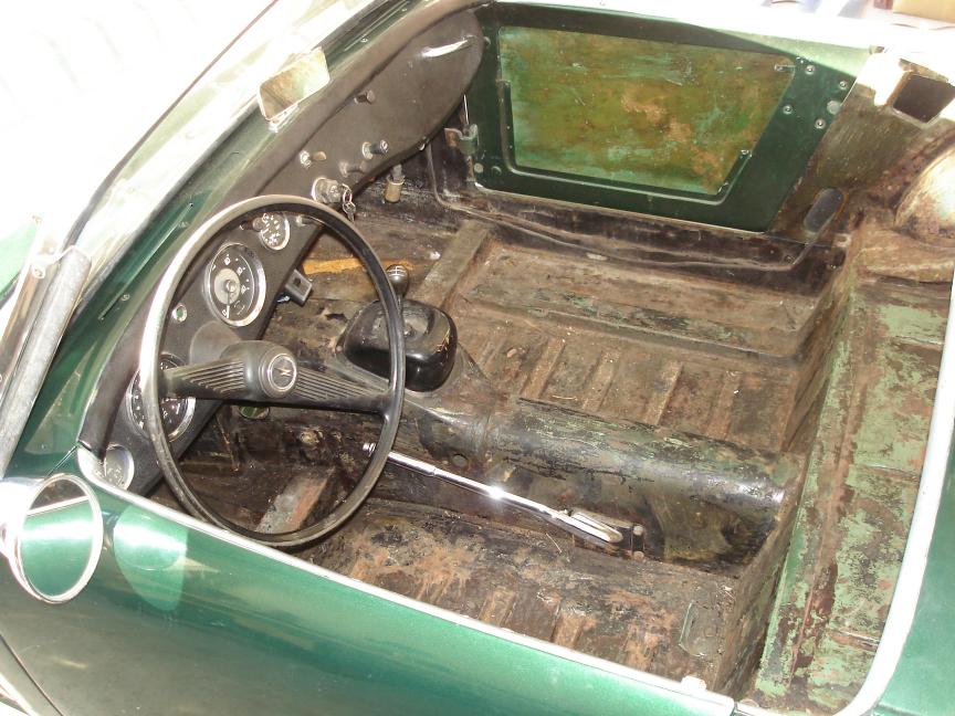

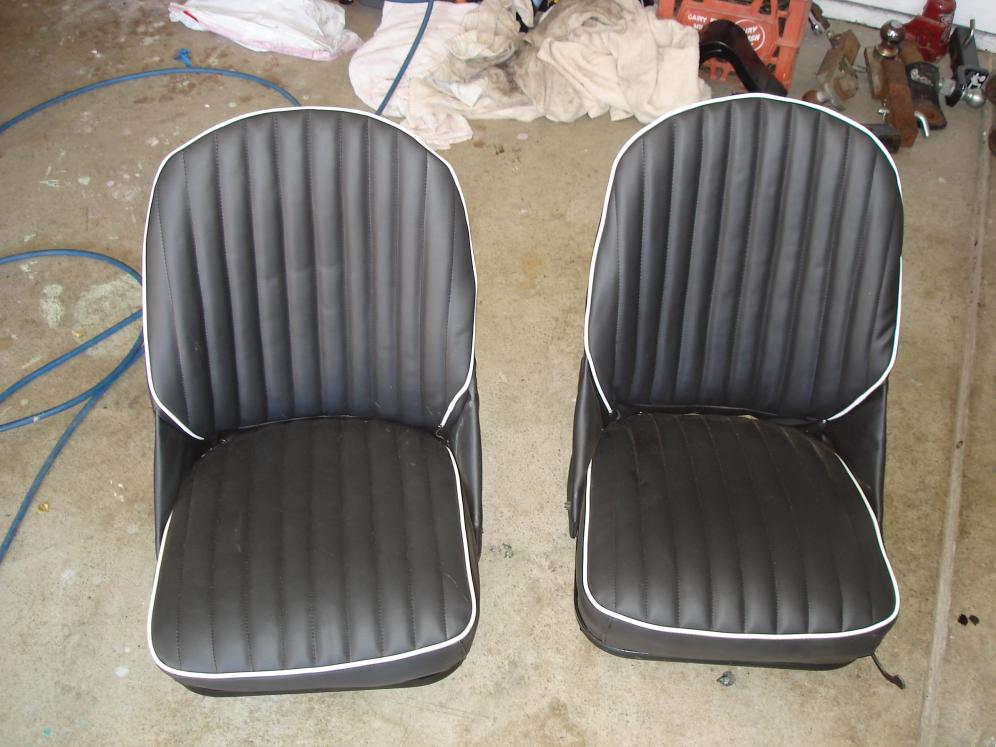

A little About the car: 1960 Bugeye. Interior is missing except for the dash. Which is complete in very good shape. The seats have been redone but never installed in the car. Car was in storage for the last 10 years. Southern California car. So the only rust on the car is a small hole under the drivers feet about 2" maybe. It was painted at some point in the distant past. Paint is still in very good shape. Hood is nice with no rips or wear really. It cranks and idles exceptionally well. Under bonnet it pretty tidy, need a little cleaning up and heater duct replaced. But overall seems pretty solid mechanically.
I would like to rebuild the car into more of a driver then show car. How important on these is it to remain true to stock. Especially in terms of interior. It isn't there and unfortunately I am not super familiar with the Bugeye original interior. Also, any suggestions as to the best source for the interior parts. It seems Moss Motors has most of the interior parts, but I have never dealt with them for this many parts. I have just bought an item or two over the years.

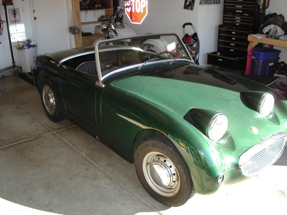

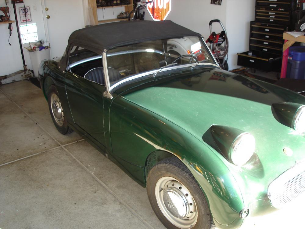

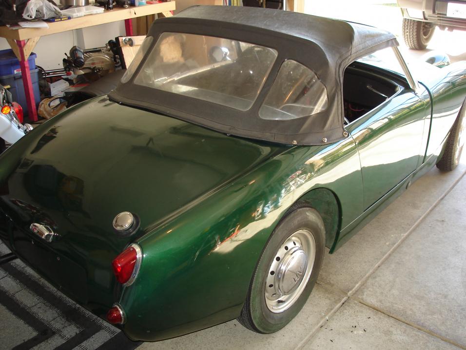

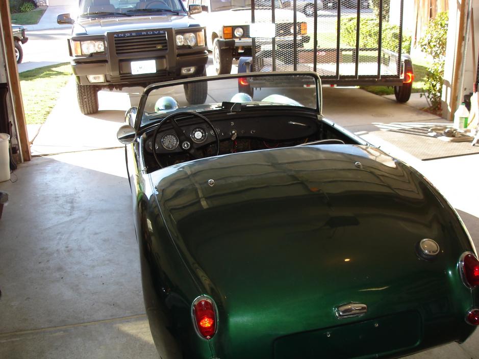

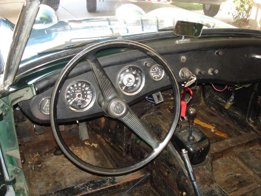

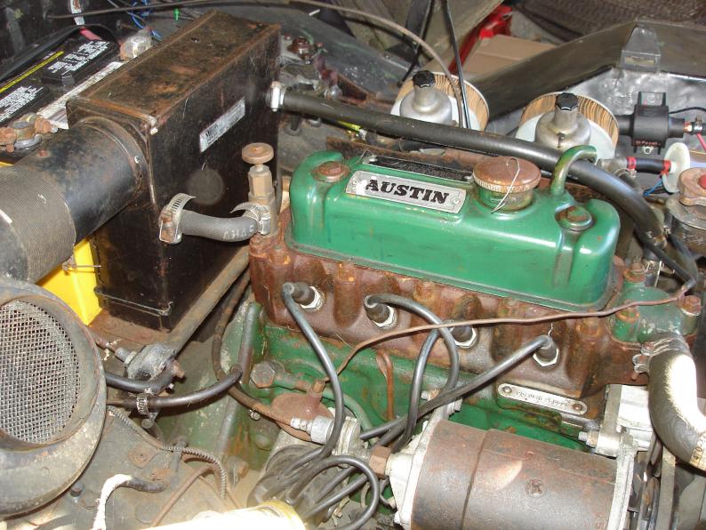

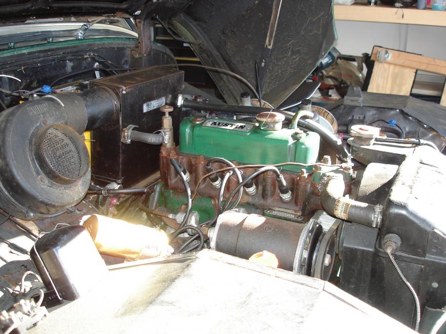

A few pictures. Took it for a run around the neighborhood this afternoon. Nothing out of the ordinary wrong. Needs the brakes done, maybe clutch cylinders. Not much clutch there about an inch maybe. Lights need a little work. I was thinking about replacing the harness with one of the repro harnesses, but I haven't really made up my mind on that since I haven't dug into the electrics at this point. But other then that I would say it's a very solid car for the money.
HealeyRick
You did well. Carbs are HS2s from a later car as is the speedo. Floor rust is an easy fix. An original wiring harness will be black cloth covered with a light blue tracer. Replacement isn't difficult, just fiddly. If the car is correctly wired now, you can cut out the old harness leaving about a two inch pigtail on each connection to use as a guide when you connect in the new wire.
