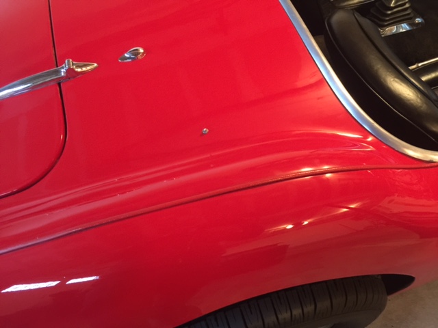

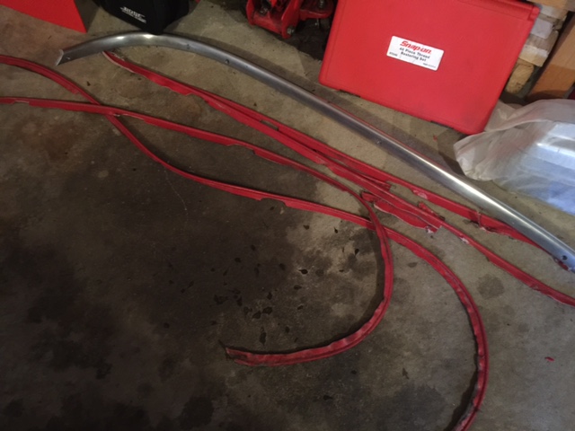

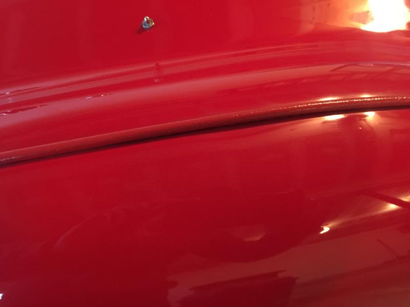

I cant wait to replace the red vinyl piping that was installed by a previous owner! I removed them today and it already made a huge difference!

That's the stock material that is used for seat piping or covering the door pull cable, or at least it looks like it. Never seen that particular modification before. It is probably better than the use of Bondo to fill the bead gap, which I'm sure many of us have seen at least in photos if not in the flesh.
