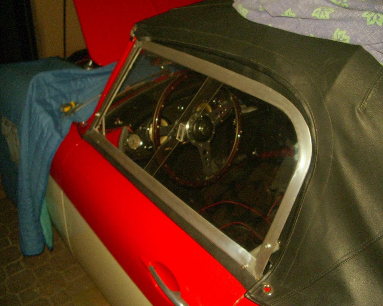

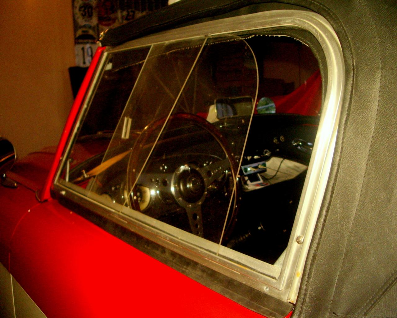

I have fit the sidescreens on my BN4 1957 Longbridge car, after some works on the brackets, the fitting is OK on the front windshield on the doors base and at the rear, BUT the upper part of aluminium, IMGP2192ab.jpgIMGP2191ab.jpg result so far from my Everflex TOP that a raining day can be a disaster, TOP frame appear to me in the correct position and TOP appearance without sidescreen are goodIMGP2179.jpg
Any suggestion to avoid wet days??

Your side curtains are on the wrong sides. The smooth side of the aluminum fits against the top. Just switch the brackets from left to right and you should be in much better shape. Good luck, Bob
johnea
Turning your side curtains around like Bob says would also bring your side screen knobs on the inside of the car, where they're supposed to be . . . .

The six cylinder side curtains, Longbridge included, cover the same open area. Your brackets appear to be later, non-Longbridge, as are the frames. Keeping the brackets where they are on the doors, and removing the frames and switching them to the other side, will make them work. The plexiglass will then overlap correctly, with the forward window over the rear panel. The inner one will be the slider. Smooth side of the aluminum touches the flap of the top.
The diagonal seam that points to the turnbuckle of your top indicates that it might be the pattern for the later cars, as the Longbridge top seam is more horizontal and should be in the same position as the top bow.
Good luck, Bob

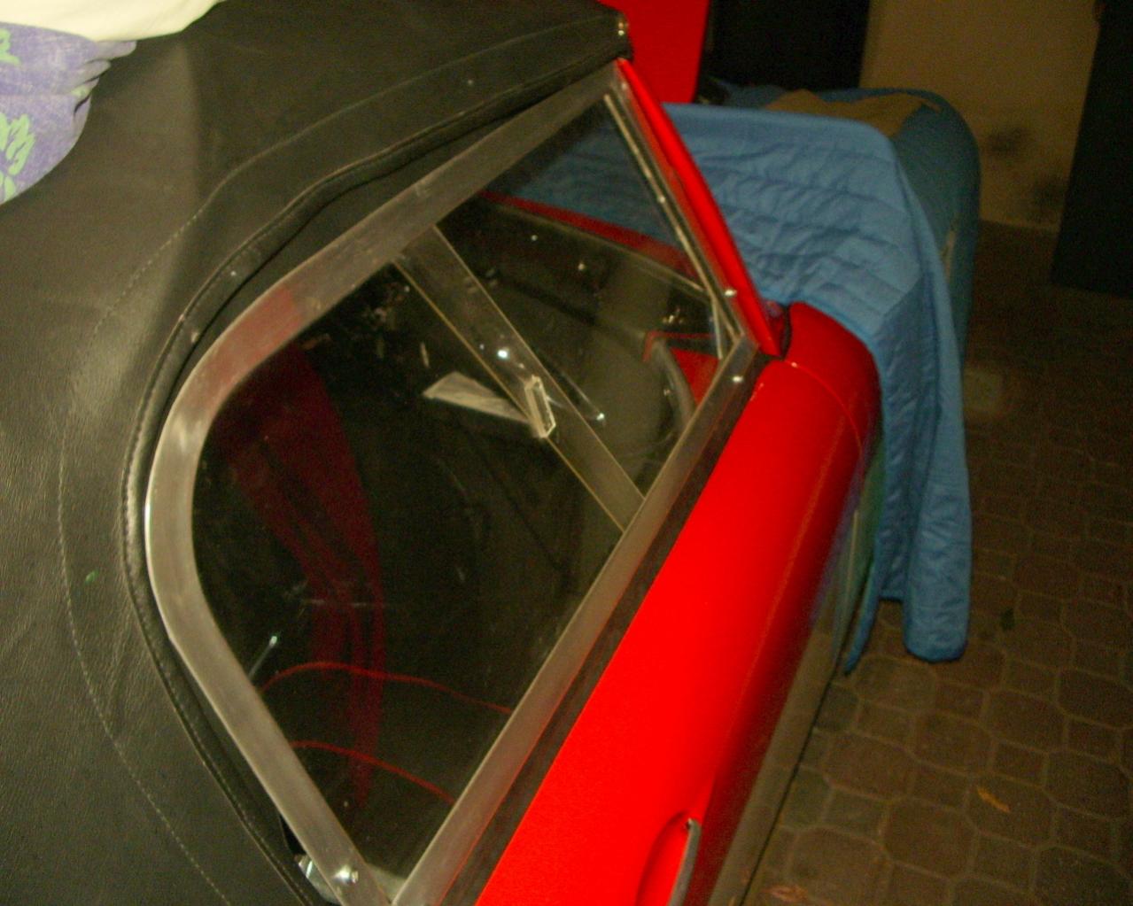

Tanks to BOB suggestion I have realized that my sidescreen was mounted on wrong side,
now with the knobs at the interior of car and the water opening on the aluminium base direct to the outside the situation are more comfortable- NOT perfect but correct IMGP2199z.jpg
