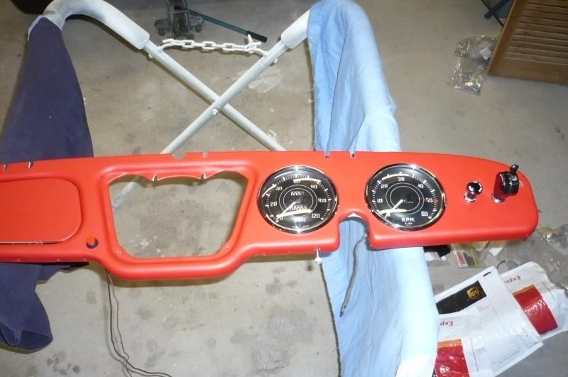

I’m about to start recovering my dash on my ‘61 TR3a. The PO had painted it. I sanded off all the old pint and put it in primer until I got to this point. Now I’m wondering if I should strip off the primer before I put the contact cement down or is it ok to leave on there?

I don't know if this is documented or at what point it was done or how it was done but it appears that the later 3A had a molded vinyl covering on the dash. My '59 pre-60k has the standard vinyl glued on while my '60 post 60k had the molded vinyl. I mention this because it is difficult to reproduce the molded shapes with stretched vinyl. I think that there are stretchier vinyls available today as well as better glue so you may be a able to get a perfect job, otherwise look at older cars as your standard.
Tom
RJCOX
I just removed the vinyl from my 60s dashboard and it was really thin (molded?). Nothing but bare pristine metal underneath.

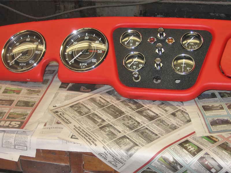

I am actually contemplating doing the whole thing in the wrinkle finish that I just did on the center panel. Thankfully, if I did (or do), my interior will already be black. Drawback, what will I do with my glove box door?
Ok, so the takeaway here is that the dash must be primered before gluing down vinyl?
Oh, BTW, VHT wrinkle finish says to cure by baking for one hour at 200 degrees, but I left mine under halogens for a week and it came out hard as a rock.

As to drying the wrinkle paint. I try to do that painting in the summer. But then it gets in the 100's here and I just use the sun to dry them.
