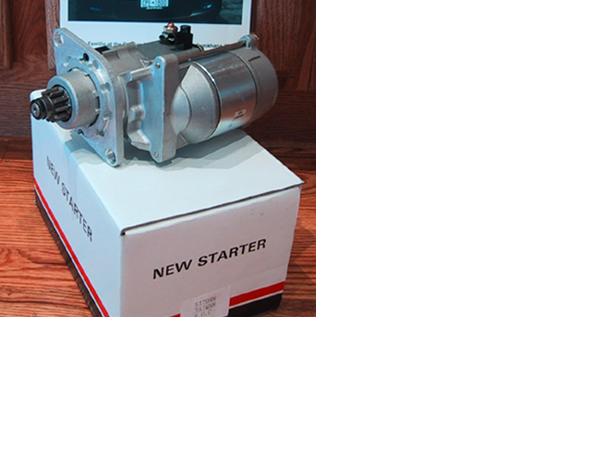

I bought a new starter for my TR8 from TRF. It is shaped differently than the original one and has "made in Japan" on the box. It bolted up without a problem but now the catalytic convertor won't go back on because it hits the starter. Has any one else had this problem? How did you fix it?
Thanks.

What position is the soleniod in? Stock TR8/Rover past 1976 are on the side if looking from the fron about 9 O'Clock position. If you have one where the soleniod is at the 6 O'Clock position then this is a high torque pre 1976 starter for a rover V8. That will most likely hit the starter. Now the Japan thing sounds like you got a mut-starter.

You are correct, the TRF part number is GRS106. I did a little web searching and found a picture of my starter. On this website it is advertised as a Rover part. You can see from the picture how the solenoid created a problem.

Well if I was you I would return it stating the application is incorrect period! Then go on ebay and buy a used high torque rover starter the tiny new ones that go for about $50 to $75 used.

I should have asked the forum BEFORE installing this one. With a little help from a BIG hammer I was able to customize the catalytic convertor so everything is happy. Thanks for everyone's comments.
