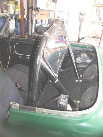

The car had a pair of speakers mounted in the rear wall, as is usual. I decided to leave that in place (although I did upgrade the speakers themselves.)
I then added the second set below them. I simply wanted a bit more 'ummph' when the top is down. These are mounted in a false panel. No cutting of the car was done here. (Not that I'm overly shy about doing that, mind you...):
You will notice the seats do not match. I had installed Miata chairs, but mine was killing my back. So I removed it, and installed a Kirkey racing seat, and then built it to fit my bad back. I had got used to having the headrest speakers, so I took advantage of the racing seatbelt slot in the Kirkey to mount a couple small speakers:

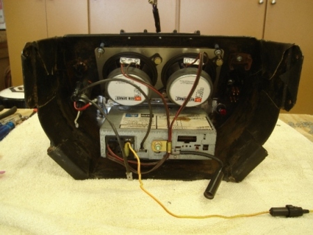

As has been mentioned, using all these speakers can be too much for a little car stereo. In this case, I've wired the four rear speakers directly from my car stereo, which it is designed to do. Due to the dimensions of my stereo, I mounted the console at a more inclined angle, and installed the stereo where a set of small speakers had previously been. This allows enough depth for the length of my stereo. The console is the stock item; I covered it with a wood facia, just because:
For the headrest speakers, I'm running two very small amplifiers, one per seat. These amps are made for motorcycle installations. I have mounted them where the car stereo usually resides, and designed the facia to hide them:
Yes, the facia is held in place with velcro. I was not sure I would like the wood, and wanted an easy way out...
