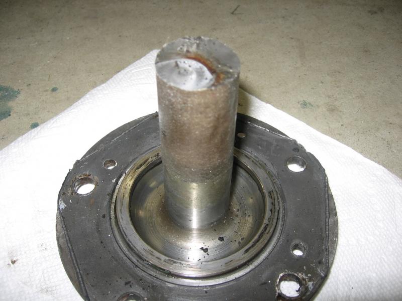

Something broken inside the axle housing. I don't know Healeys at all, but my WAG (wild ass guess) would be the shaft broke at the splines.
This is a Sprite rather than a 3000, but shows the kind of damage I'm imagining.
R
RonR
I have seen the Sprite shaft problems many times on friend's cars.
It does sound like my car has the passernger side axle broke. I am heading out to remove it now.
The next question will be, if it is broken, do I replace both 57 year old shafts or just the broken one?

My inclination would be both of them. Most likely a metal fatigue issue, and they've both seen very nearly the same stresses for all those years. You might get a few more years out of the other one, but why take the chance on having a trip interrupted when it eventually does fail?
