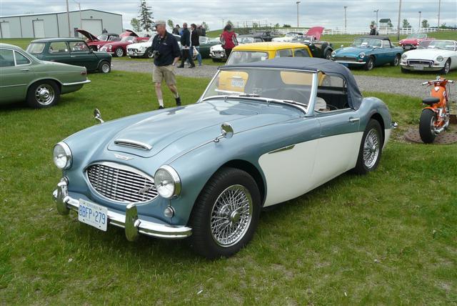

I need a little bit of Healey blue to do some touch up a couple of chips. So I phone up the old owner me told me they took the old trumk lid to a paint shop and did some kind of computer match.
Never did manage to find any touch up paint
Cheers
Mark
