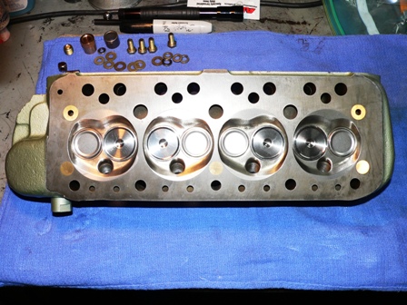

Be sure to drill a small (bypass) hole (around 1/8") in the perimeter of the thermostat and leave everything else as it is
