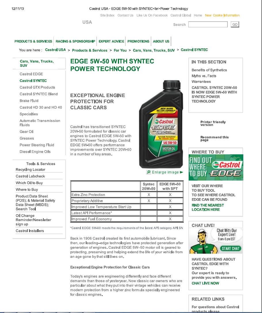

Not an answer to your question, but I found this thread on Castrol Synthetic "Edge" having sufficient ZDDP for flat tappet motors interesting: https://www.mgexp.com/phorum/read.php?1,2532440
Good reading.
It does say...Only Castrol EDGE with SYNTEC Power Technology (SPT) SAE 5W-50 has been recently reformulated to have a boosted level of ZDDP (1300 ppm) to help protect flat tappet cam engines in classic cars.
I use Castrol GTX 20-50 as what's recommended by most for the Healey.
I don't think Castro makes EDGE in that weight, plus it's syntec and that's not what's recommend by Healey either.
I'm very happy with Castro GTX 20-50 and adding ZDDP I believe is the closest to what is recommend by the manufacture.
A quick check of the MSDS for ZDDP (or ZDTP, take your pick) https://msdspds.castrol.com/ussds/amersdsf.nsf/Files/4F5CC6443367512480257BBA00527D2F/$File/221024Castrol%20EDGE%20with%20Syntec%20Power%20Technology%205W-50.pdf does not list ZDDP. If the oil contains it, it must show on the MSDS because of its hazardous nature. Now, the MSDS is dated July of 2013, so if they reformulated since then, they better get the updated MSDS out soon, or the EPA and OSHA will get on their case.
