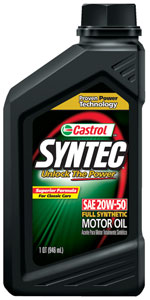

Brosky

What about the 8o's and 90's vintage V-8 as in the wedges?
Castrol SYNTEC 20w-50 Motor Oil
Classic & Vintage Vehicles that Qualify
Pre–1949 1949 — 1961 1962 — 1973
► Historic
Restoration ► Historic
Restoration
► Hot Rods ► Customs ► Muscle Cars
► Street Rods ► Rat Rods ► Pony Cars
► Customs
► Pro Street
► Pro Touring
Well the format came thru on the preview screen.
Brosky
Don,
I have the link posted above and 12 quarts sitting in the garage.
DNK
Plan on using it for the 6 but is it a big deal in our V-8 Wedgies??

First rule of car ownership:
If it makes you happy, then do it!
I'm happy to see that another Triumph Brother is on the Castrol Syntec band wagon.
