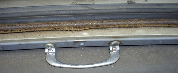

I'll have to look at mine, but off hand I think it is covered.
GregW
Platinum
Guess the next question will be "What Color" or is that colour? My BJ8, with a OEW paint job, has an off-white vinyl wrap on the wood.
shorn
The color is off-white to creme. i believe that British Car Specialists carries the correct vinyl, but I found mine at Phoenix upholstery in Vancouver, BC. I can recommend Phoenix for any interior work.

Hi Shorn,,
Looking at your picture it's difficult to tell what (if anything) is painted or covered. In one set of instructions it says to cover the aluminum channel with fabric, you say the bow itself. Can you be a little more specific.
Also, if you have any pics of things like how the top is connected on the sides, or in the rear, or if there are some metal trim pieces at either side of the front bow, anything would be appreciated.

Hi Robert,
Wasn't sure if you were asking me about more photos or Shorn. I don't have many, I didn't want to disassemble my top until I welded the wheel arch bases on. Here is one that shows the side from the inside. You can see where the wood is covered in the vinyl more clearly. The vinyl is the same color in the first shot I posted.
