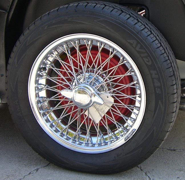

If you're not pulling high G's in the turns or lighting up the rear wheels, 60 spokers will be more than fine. I think for you, it boils down to taste. I've seen some cars where they painted the spokes a different color than silver and looked quite nice. New wheels are a fairly big purchase, definitely sleep on it. I went with 16" 72 spoke wheels. They have heavy duty stainless spokes (you have to ask for that). It doesn't sound like 16" is available anymore, but it never hurts to ask. :wink:
BTW, I have heard from a couple sources that British Wire Wheel has gone out of business. I always recommend Hendrix anyway. Here's a shot of one of my wheels.
Oh, one other thing to consider is the tire you want to use. I researched both at the same time. Tires for the original rims are getting hard to find in a tall profile (what it was originally). Modern tires tend towards a lower profile. That lead me to the 16"x6" rim where I could get a diameter similar to original and I could buy a replacement at any tire store. The downside is wider tires will stick out and can rub on the stock fenders.

Back to the original topic, I'd highly recommend Dayton 72 spoke stainless with tires shaved, mounted and balanced by Alan Hendrix. Many wire wheel problems, out of balance, out of true and scuttle shake can be directly traced to improper tire mounting. Hendrix knows their stuff and are excellent to deal with.

Greg steps up the attention to detail by including the original cream colored purchase tag, still attached with that piece of sting, to one of his spokes. How can we compete with that.
:lol: Them tags ain't original! Those were from Hendrix. When Allen shaves and balances the tires, he marks the tags as to where the wheel should go on the car. The better balanced ones go on the front (until you rotate them of course), but it gives you a reference point. 'Sides, I think those red brake drums would get a point or ten taken off any score I might have. Been contemplating changing them to black for no particular reason.

Actually, not wanting to be accused of doing anything halfway, I bought five (5) :wink:
I ordered the tires tonight from The Tire Rack, so they'll be here Thursday. It's been a long time, but I'm going to try and mount them by hand; we'll see how that goes...
GregW said:
Patrick67BJ8 said:
Only three wheels???
So <span style="font-weight: bold">that's</span> why they were 25% off
They looks great Randy.
There's nothing wrong with your math :wink:
Thanks though; they're a little "smudged" up, but they'll clean up with some WheelWax and a little rubbing (saying "elbow grease" would be exaggerating).
