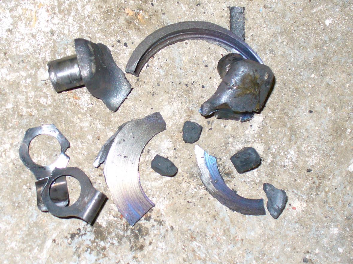

Took the motor & tranny out this morning, 3 hours from draining fluids to having the motor & tranny separated... not a bad job to do, never done on a spridget before - Now... I was sure my release bearing was shot... they say a picture say's a thousand words...
Bayless
Yep, I think you diagnosed that one right. I wouldn't reuse it.
I'd go ahead and renew the bushing in the fork arm pivot. It may feel ok, but after you clean the oil and clutch dust out of it ... it will probably wobble. I think some of these get beat up as the throwout bearing is taking a beating on its last leg.
Rut
I don't know, looks almost new to me!
Agree with Trevor completely and would add that you should check to make sure your TO arm isn't bent and that the new TO bearing ends up exactly concentric to the exactly centered main shaft when you're done. I blame a similar mess in my BE a couple years ago on a TO bearing that wasn't running true because of a bent arm.

Good advice from you & Trevor, I will check both of those things out , Thanks - I don't want to have to go this deep again for a bit ! wheeew did that thing ever blow !, I don't know the history of the car, but I have put a few thousand miles on it since I bought in fall of 2010 - It had been apart before but not sure when or what was changed... very little warning, I was driving one day & didn't notice any issues, the next time I go to back out of the garage & I hear some nasty growling when I touched the clutch... at least it happened at home in the driveway !

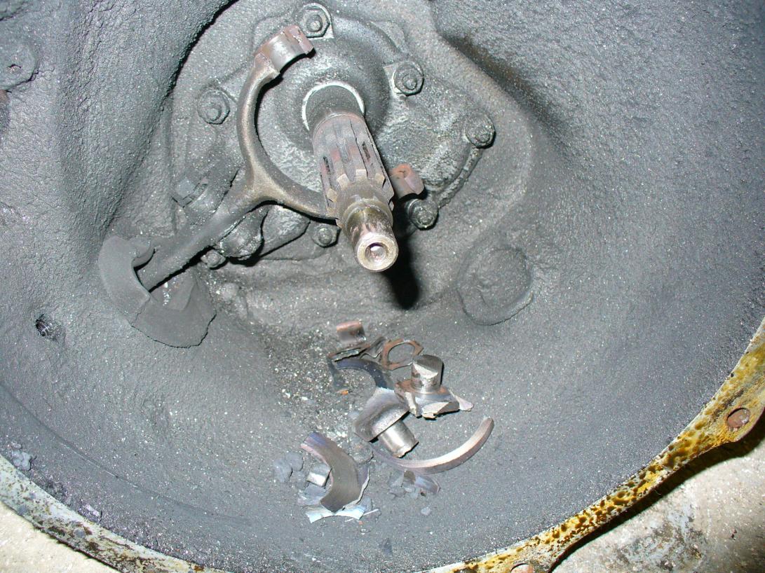

Clutch fork was toast, bent & twisted ! I was fortunate enough to source a good used spare from another participant in the University Motors Gearbox session earlier this week (thanks David !!)

Discovered that the old pilot bearing had fallen out of the crank when I had removed the gearbox, so that must have been slipping in there, installed new pilot bearing & it had a good tight fit no idea why the other bearing had slipped out, but the D.P.O. had all kinds of interesting repairs done on this car :smile: Also discovered the push rod had been "extended", that explains the bent clutch fork, well explains how they choose to deal with the bent clutch fork ! I cut it back to the correct length - Car fired up good, shifts thru the gears nicely (at least for the short trip I took it on) - next weekend I will install the grill, bonnet, do a sanity check & take it for a good long run !
