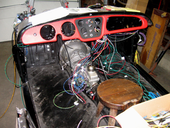

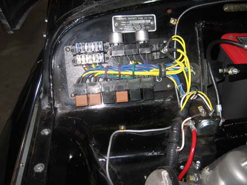

The other alternative if you're not into having the car bone stock is to install the harness offered by Advance Auto Wire. His harness uses multiple relays and fuses along with higher ampacity wiring. It's a lot more work installing it, but I feel it was worth the effort. Besides that, I like doing that kind of work.
