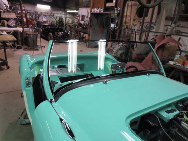

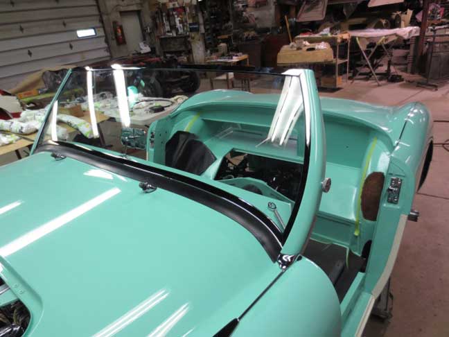

The correct "curve" can be done. A couple pictures of my 100M being done by Fourintune. Restoration was completed last week. Fit is perfect.

Dave Russell, maybe? Unfortunately, that thread was probably lost when the forum migrated platforms (we lost Dave several years ago).
