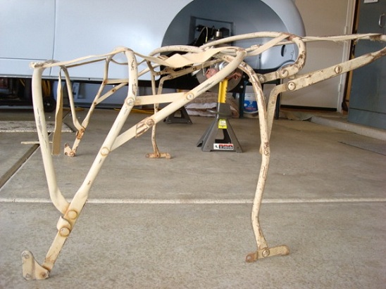

I have two top frames for my car and need to know which one is correct for a 1956 TR3. I think it's the frame on the right. If you look at the pivot arms you will see they are not the same. The frame on the right even has a snap on each side on the inside of the center pivot arm. It also looks like I would need to remove the triange shaped mounting bracket from the one on the left if I'm correct. I'm sure this is one of the many changes made over the years.

I have two 56's, don't remember the rack having that sharp bend and do remember the pinch point when you pulled the the frame forward to finish raising the top. I thinking the one on the left. Will look at my cars this week, both are stored at my mothers.

I don't recognize the frame on the right but can say with reasonable certainty that the frame on the left fits the later cars (including TR3As). I was aware of several changes to the hood but didn't know about frame changes through the years.

Can't you match the mounting bracket on the top frame to the mounting point to the body? It sounded like you might have already tried that since you mentioned "removing" the triangle-shaped bracket from the one on the left.

I agree the one on the left is like the frame on my TR3A so perhaps it's the one for a '3.
Possibly the one on the right is for a TR4? I didn't put mine up to check (anyone who has a TR4 will understand why) but the snap you describe is correct for a 4 and the 'knee' looks about right. I did find one picture where you can sort of see the frame:

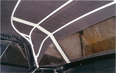

I think Geo might have it - don't have my car to check but that looks a lot like my frame in my memory anyway.
Every TR2-3 I've ever seen had a frame that looked like the one on the left. I think Geo's right. the frame on the right looks like an early TR4.
Mallard, I have never seen the frame on the right on any early TR-3. I have only seen frames like the one on the left... Pat Ballogg in Wickenberg has an early TR-3, he might know. Good Luck, Bill C. Mesa, Az.
Well I guess I was wrong on that one. It sounds like the one on the left is correct. I'm not sure which one came with the car, but now I'm thinking it was the one on the left because it is bent in a few places. I got one off ebay some time back but I don't remember which one it was.
Well I decided to look at the parts diagram and it clearly shows the one on the left to be correct. I should have done that first.

The left hoodsticks therefore look to be late TR3A/3B. Those triangular brackets attach it to the inside body. From memory of the TR4, its hoodsticks had that dogleg in the uprights, as shown on the right pic.

The frame on the left is for a TR2-TR3. The one on the right looks like a TR4 frame that has had the tri-angle shaped body mounting brackets removed. Checked them against my TR2 And TR4

Here is the frame on my 58TR3A. It is original to the car.

George and Ed thanks for the pictures. They do confirm what everybody is saying about which is which. Now to try to straighten things out. Anybody need a good hood stick for a TR4?
