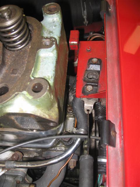

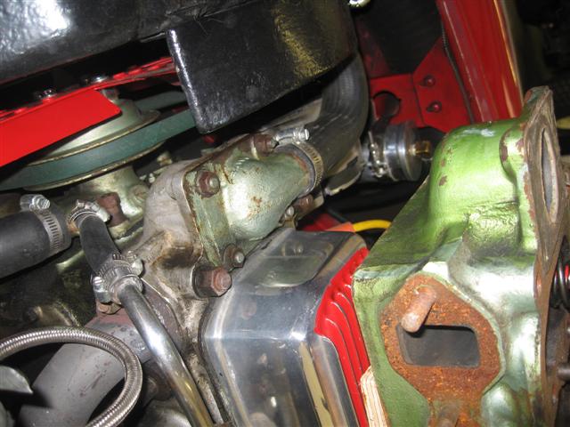

Michael, any chance I could get some more pics of your engine, for reference? Pretty please.

Eric--
Here's the first of four comparison photos (attached) The iron head is the one sitting on top of the valve cover and the aluminum one is the one sitting under it :->.
I doubt you can see the differences in any of the photos-- they are VERY minor and have to do with the sharpness of the parting lines, etc. etc. Even the "Westlake Patent" info is the same.
FWIW I think that before you do anything you should exchange some emails with Dave Russell--for my money the smartest guy on this list. I think he can shed a lot of light on the project that you are considering.

Here's another shot from a different angle.

One more.

There is, of course, one give-away: The exhaust header is tubular. However DW offers the head in full-stock configuration so I guess you can use the stock exhaust manifold with it.
