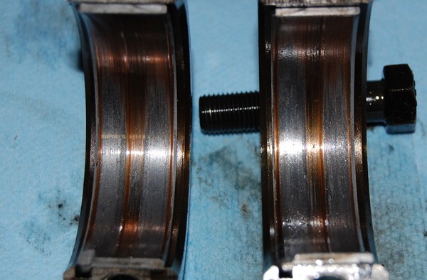

The pistons are out. I found broken edges on the rings of two of the cylinders. I am waiting on a 'dingleberry' hone from McMaster Carr to break the glaze on the cylinders. The rod journals looked great except one. Should I put new bearings on this one, or put the old ones back in since they conform to the uneven journal? My goal here is to get a couple of years out of this engine until I can throw enough money at it to rebuild it right. I have attached pictures of the damaged rings and the very worn bearings. Thanks again for your input.

poolboy
I'm not a machinist, but it looks like you still have a lot of good bearing surface left. The streak of babbitt missing in the middle doesn't look like it came from inadequate lubrication rather from something that the oil picked up that got lodged between the bearing and the journal.
Looks like what damage was done is done and over with.
For peace of mind, at least my mind, I'd probably replace it.

aeronca65t
To my old eyes, the bearings look like they have fairly normal high-mileage wear. But I wouldn't put them back in. A new set of rod bearings will help things last for another few years. Be sure to measure the rod journals on the crank just to make sure they are reasonable.
By the way, I see similar wear in the 1500 (Spitfire) engine in my 1500 race Spridget. The 1500 engine is essentially a 2/3 version of the Triumph Six with same rods, bore spacing, etc. I swap out rod bearings on the race Spridget about every 20 to 25 hours and it gets around 15 oil and filter changes during that time. They show wear almost as bad as your's (and my crank still measures perfect from a regrind I did a few years ago).
Don't forget new thrust washers! They're very critical in these engines!
The new rod bearings may slighty bump your oil pressure up a bit too (a good thing).
If your bores are within 0.003", new stock rings will give you a few more years. The dingleberry hone is OK, but wash everything out well afterwards. You do need to get the ridge off the top, though. Even a small one isn't good.
