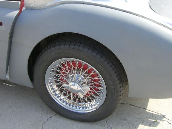

Hi Charlie,
What I did was research what kind of tire I wanted to use first. Width, diameter and side wall height. Then before buying them called Hendrix to see what was possible for that tire with the Healey. Turns out Dayton can make pretty much whatever you want. They mated a 16x6 rim to a Healey hub with heavy-duty stainless spokes. If you look at their catalog , they have a selection of lace patterns also. Since Hendrix didnā€™t carry the tire I wanted, I bought them through TireRack (a link is on this forum under ā€œSupporting Vendorsā€) and had them shipped directly to Hendrix for mounting, balancing, shaving and fine tuning the spokes.Here's a photo of what I wound up with.

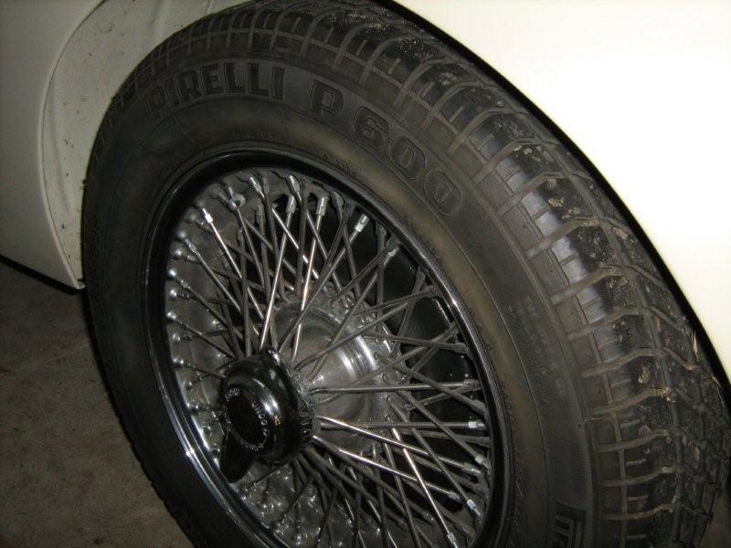

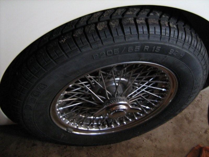

I got 15x6 60 spoke Daytons front and rear with 205x15 front and 215x15 rear Pirelli P600's on my BN1 (narrow drums!), they stay inside the guards, except they will probably throw up dirt onto rear gaurds where the guards curve in, drives nice though, no tramlining, and steering isnt heavy, just got to watch tyre pressures!

Here are a couple of pics, 195/205, not 205/215!
