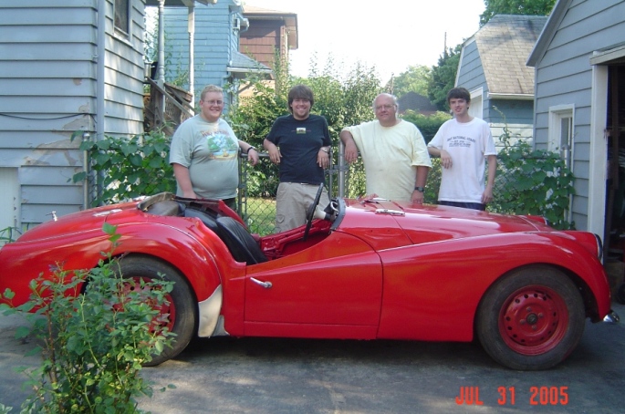

What size wheel and tire is standard on a TR3? Also how much variation is allowed? Can I go to a 7" width on the a 15" wheel, and if so what kind of tires would fit? Any help would be appreciated.
