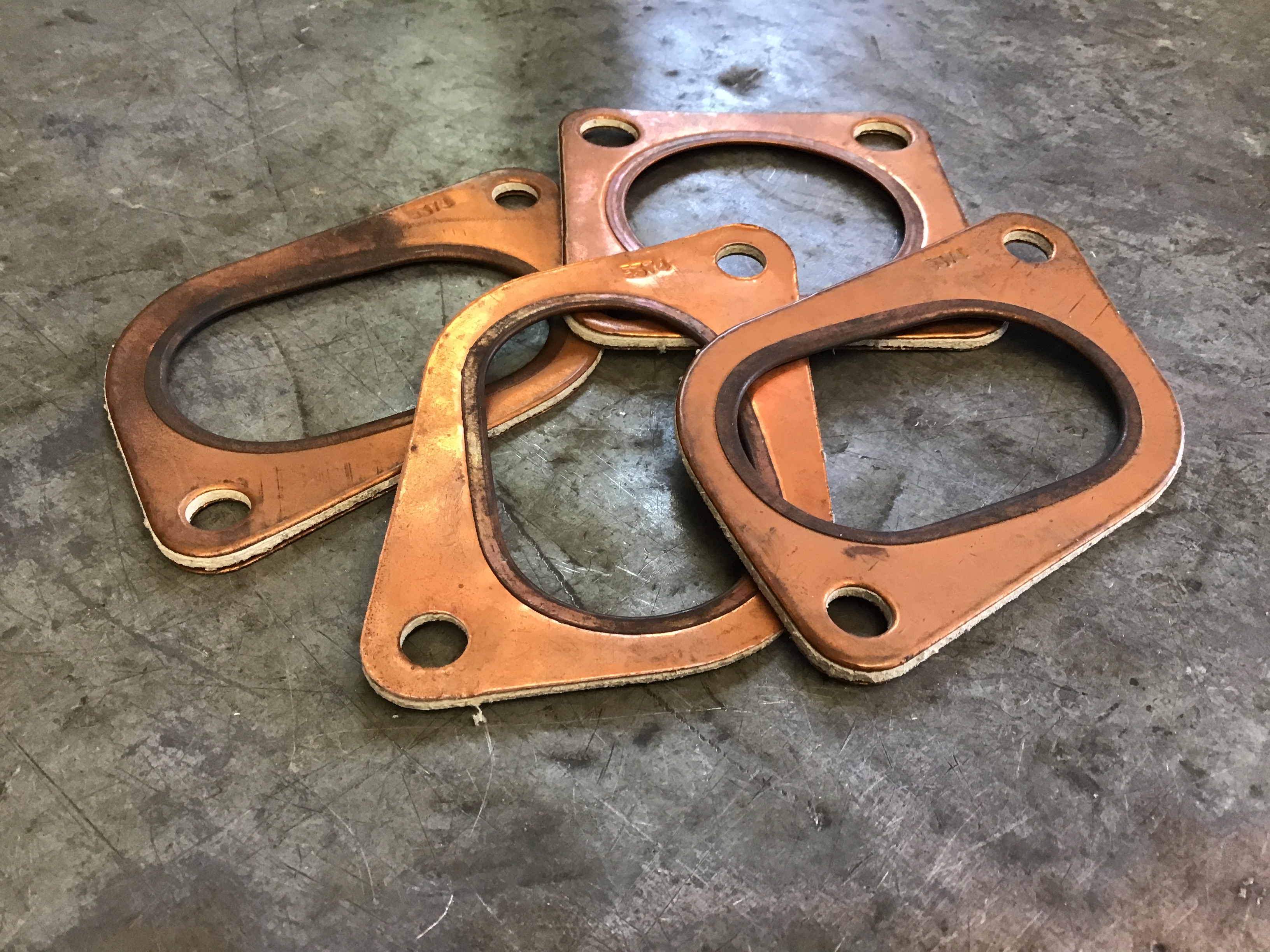

Check out these gems I picked up for a Talbot job.
Nice!
