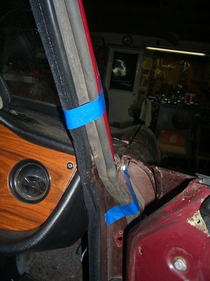

I taped the seal in place that used to be on the car when I bought it. Here is a pic.

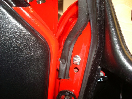

I hope this helps

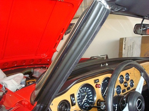

mallard
And this

Thanks for the pics, Keith. My seals do not look like that. I have the fuzzy inner seal with the rubber going to the outside that goes all the way around the door opening. Then I have the rubber drip seal that ends at the door switch. Did you cut the width down on the short rubber seal? It seems like the distance between the two seals is much larger with my two seals.
Kevin
mallard
TRF has two sizes for the outer seal. I put the larger one on my car just to make sure of a tight seal. I think I could have used the smaller one without any leakage. you may have the smaller seal on your car. I also tucked the flat part of the seal under the fuzzy door seal when I installed it on the windshield frame.
